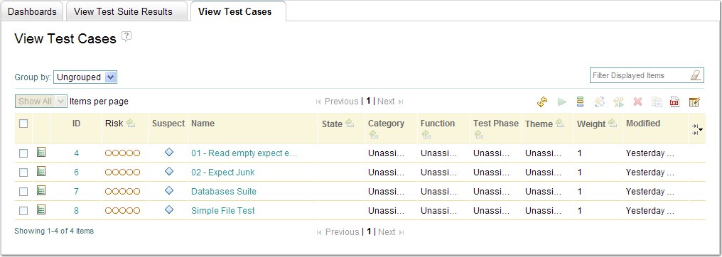

click Browse Test Cases on the Construction module.
All available Rational® Quality Manager test cases are displayed, including the cases exported from Test Integrations and APIs.
- Select one of the Test Integrations and APIs test cases by checking the box to the left of its entry in the list.

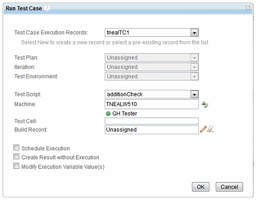

Click the Run Test Case icon
above
the list of test cases.
The Run Test Case dialog is displayed.
If wanted, modify the available execution
and results options, then click OK to execute
the test case.
Note: The Test Script option can be used to select which test script (that is, which environment) is used when the test case is executed.

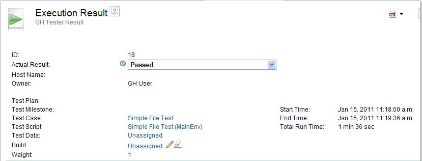

When the execution is finished, the status is displayed in the console, and the "Execution completed" notification is displayed in the execution tab.
To view the detailed results of the execution,
click Show Result.
The results are opened in a new tab in the Rational® Quality Manager console, showing the detailed execution results (the same as for any Rational® Quality Manager test case).
In the Result Details section, a link to the Test Integrations and APIs log for the executed resources is available.
Click the log file name to view it.
Note: Results for Test Integrations and APIs resources that are executed by using Rational® Quality Manager can be viewed in the Results Gallery.
