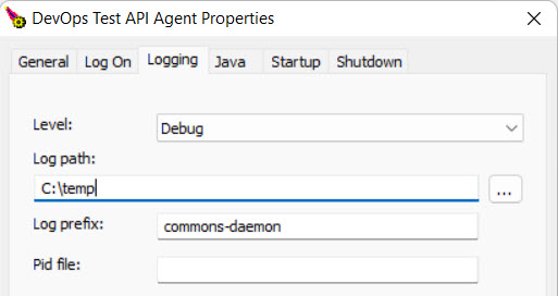

Service Logging
  1. It is possible to add low-level logging to the service itself. Run the following command:
    prunmgr //ES//OneTestAPIAgent
  2. Set the Level to Debug and configure the Log path folder name.
  3. Restart the service and check the log files. Three log files are produced:
    • commons-daemon.2023-09-22.log
    • onetestapiagent-stderr.2023-09-22.log
    • onetestapiagent-stdout.2023-09-22.log
