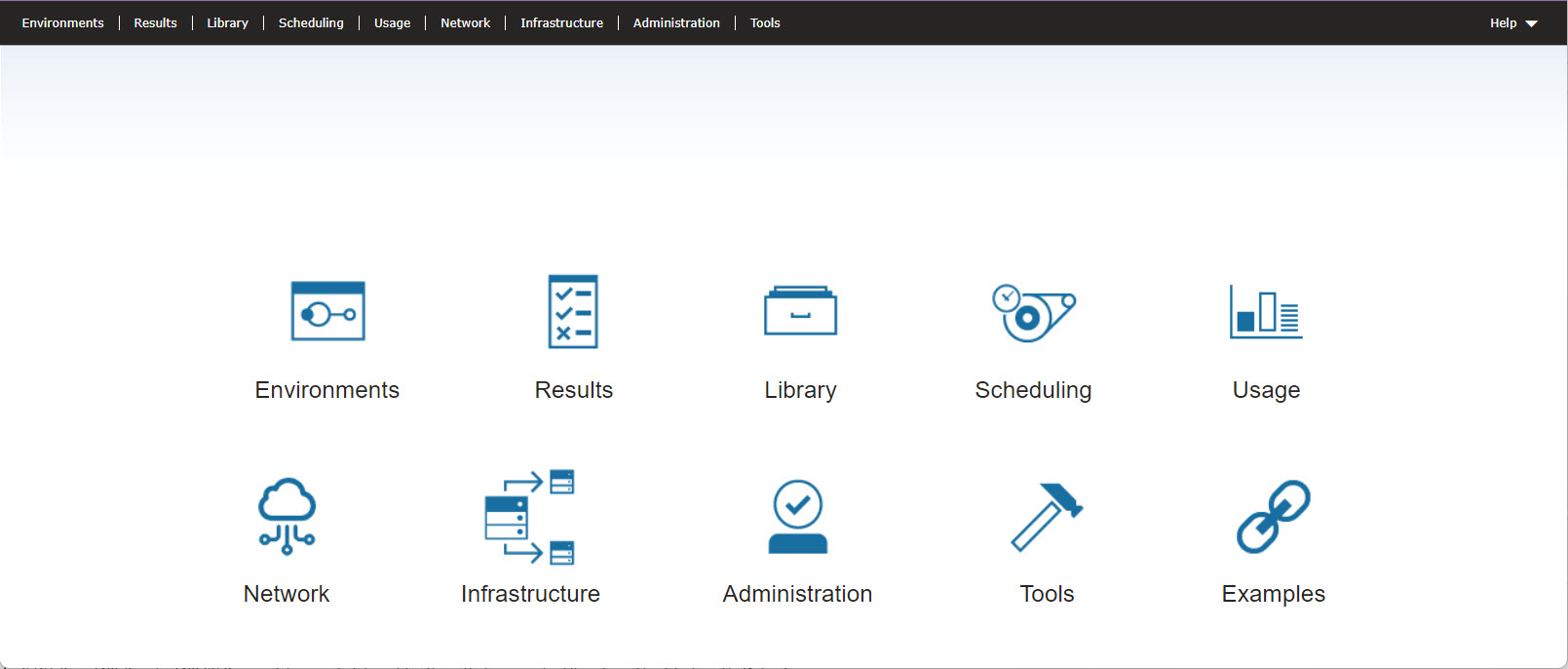

Open Test Virtualization Control Panel by
double-clicking the
icon.
Note: When Test Virtualization Control Panel starts, you can see an orange icon. You must wait for it to change to green. If the icon remains red, you must troubleshoot and fix the issue. For more information, see Starting and stopping DevOps Test Virtualization Control Panel.The Test Virtualization Control Panel Home page is displayed.
Click the Examples icon.
Under the REST examples section, you can see an example of a REST Phonebook described with a Swagger definition. This Phonebook API provides a RESTful interface through which HTTP clients can retrieve information about the phone book contacts, and update or delete them.

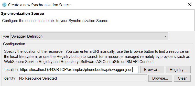

- Right-click Phonebook Swagger Definition and copy the URL, which is https://localhost:5443/RTCP/examples/phonebook/api/swagger.json.
Return to the Test Integrations and APIs window and
navigate to .
The canvas on which you model the system is displayed.
Paste the URL onto the canvas either by clicking or by clicking the Paste icon in the toolbar.
The Create a new Synchronization Source window is displayed.
- Click Next.
You have successfully created the Swagger definition in Test Integrations and APIs. The service components and operations are created in the background.

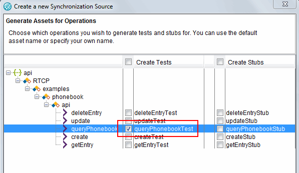

In the Generate Assets for Operations page of the
Create a new Synchronization Source window, select the
queryPhonebookTest check box under the Create
Tests column as shown in the following image.
This action creates a test for the
GET examples/phonebook/api/request based on the Swagger definition.
Click Next.

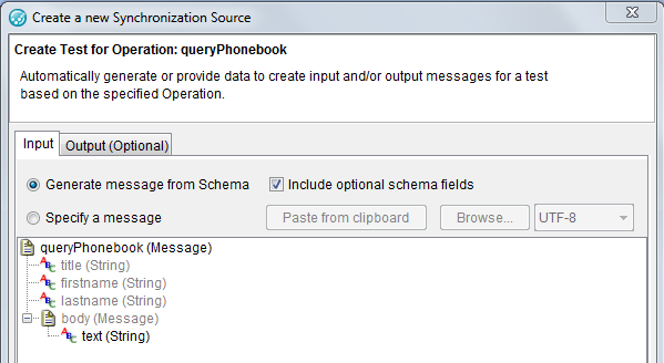

The Create Test for Operation: queryPhonebook window displays the schema fields for the test to be created, including those that are optional as shown in the following image. The optional fields are displayed in grey, which means that the values can be supplied to the service operation but are not mandatory.
Clear the Include optional schema fields check box.
The test to be created will then request for all of the entries of the Phonebook.
Click Next.

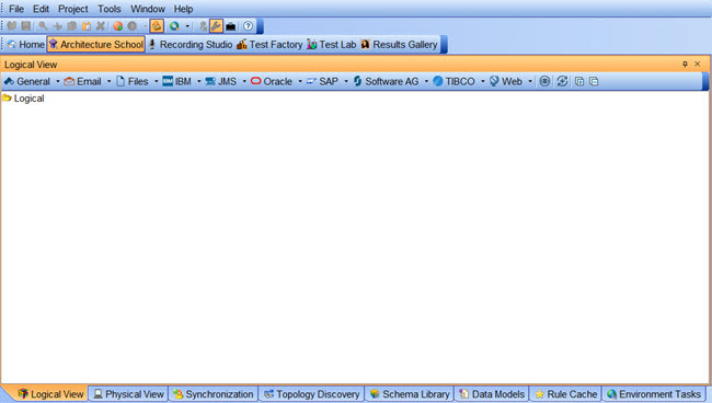

The test opens in the Test Factory perspective, which is used to create and edit tests and stubs. In this perspective, you can view the logical structure of the Phonebook sample API in the left pane.
To view the schema of the Swagger definition, open the Schema Library in the Architecture School perspective, and click JSON Schema in the left pane.

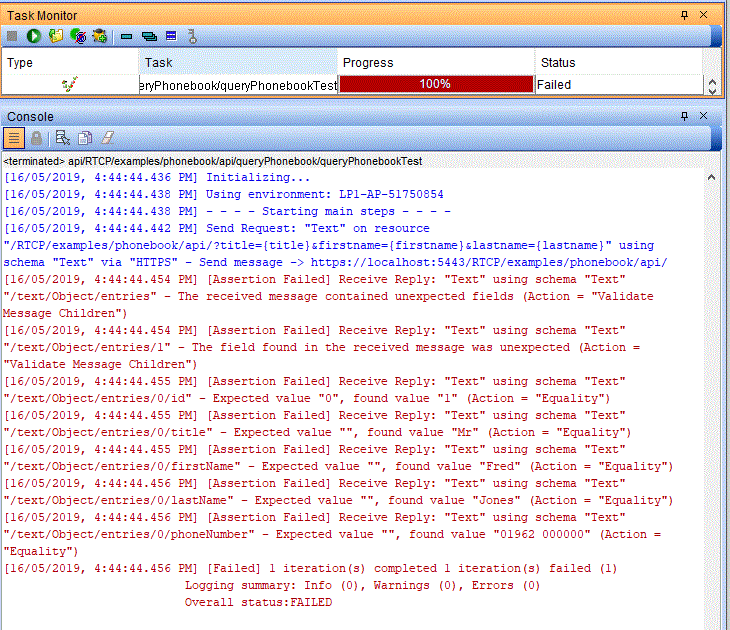

- Open the test in the test editor in the Test Factory perspective.
In the toolbar, click the Run icon or press
F5.
This action runs the test in the Test Lab perspective.
When your run the test, the test attempts to verify the response it receives from the API against the structure and data values that are contained in the test. Because you created the test by importing a Swagger definition, and Swagger definitions only contain message structure and not the actual data, the test has nothing to verify the response. Hence, the test fails.
What to do next
You can modify the test based on the response received. See Modifying the test by basing it on the response data.

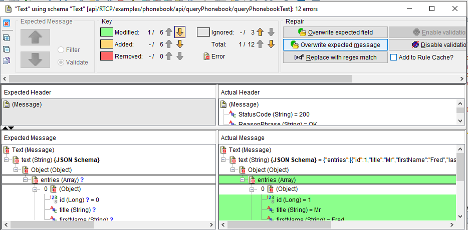

Click any line in the test console that includes the phrase: Assertion
Failed.
This action opens a window in which you can compare the expected message (on the left) with the actual message that was received (on the right).
The test contains the structure of the message which was loaded from the Swagger definition, but does not contain any data against which the HTTP response can be verified. The panel at the bottom shows a list of the assertion failures.
Click Overwrite expected message.
This action replaces the expected message with the actual message received. Overwriting the expected message is just one of the several options to modify tests from an actual received message.
More options, including those to make the verification more flexible and tolerant of variation, are described in Viewing message differences to repair validation errors.
