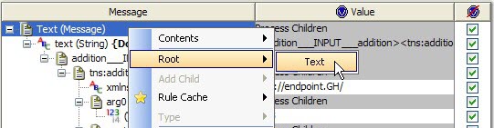

- In the message editor, right-click the base
message node and select the wanted structure to apply from the Root option.

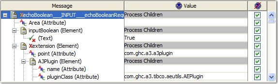

In the screen capture shown, the element Area is a new one so appears with no content. The element extension is not present in the latest schema. It is retained with its data, but it is marked with a red "X" to show that it violates the schema. Copy the data from this field. Then, remove the field.
