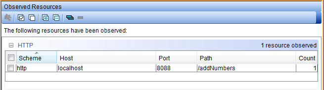

- Exercise the system under test.Topology discovery is similar to using the recording studio where you are observing processes in action. As the specified observation points observe resources, those resources are displayed in the Observed Resources pane. The resources are grouped by observation point. If a model of a resource already exists on your system, the line for that resource is highlighted in orange. This color can be changed in the project preferences. Right-click the line for the option to open the modeled resource within the project.
Click a discovered resource for more information.

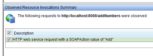

A summary of the invocations of the resource is displayed in the Observed Resource Invocations Summary pane.
