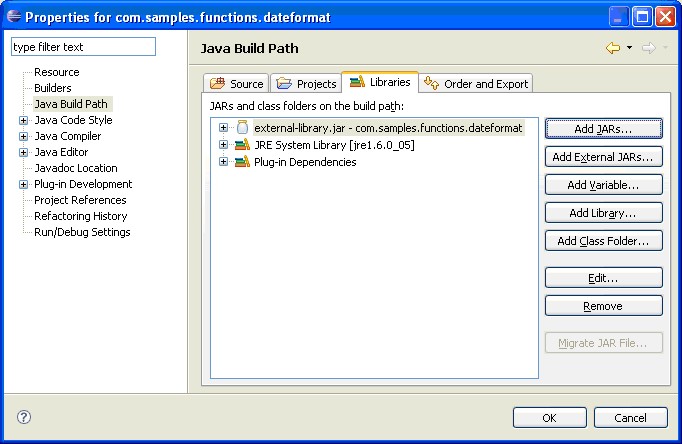

You can express a dependency on an external JAR and use it in your function. The assumption is that you have a plug-in that is defined in Eclipse as explained in Create the plug-ins in Eclipse. To add external libraries, do the following steps:
- Copy the external JAR to the root of the plug-in project.
- Add the JAR to the plug-in projects
build path.
- Right-click the project and select .
- Click Add JARs and browse for the JAR you just added under the plug-in project.
- Close the Properties dialog.
