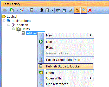

  1. In the Test Factory perspective, right-click the stub and click Publish Stubs to Docker.
    Image of the Test Factory window.

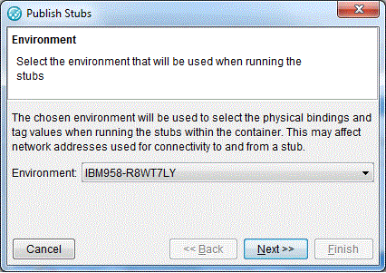

  2. Select an environment for HCL OneTest™ API to use while running the stubs.
    Image of the Publish Stubs window.
  3. Click Next.

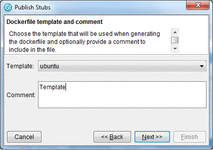

  4. Select a template.
    By default, HCL OneTest™ API provides a template, which is based on Ubuntu. This template provides the runtime and files that are necessary to run the stub. Optionally, you can provide a comment.
    Image of the Dockerfile template window.

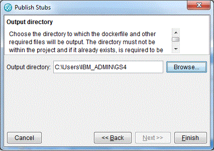

  6. In the Output Directory dialog, click Browse to select an empty folder to publish the Dockerfile and the other supporting files.
    If the folder does not exist already, HCL OneTest™ API creates it.
    Image of the Output directory window.

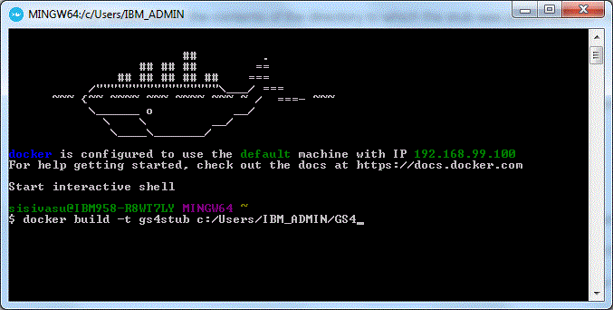

  1. Open the Docker Quickstart Terminal.
  2. Run the following command: docker build -t gs4stub c:\Users\IBM_ADMIN\GS4
    Image of the command window showing the command run.
    If the image is built successfully, you can see a message similar to the following at the end of the status message: Successfully built 914d41372c5e

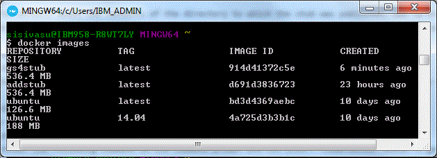

  3. To verify that the Docker image of the stub is successfully built, run the following command:docker images
    Image of the command window showing the docker images.

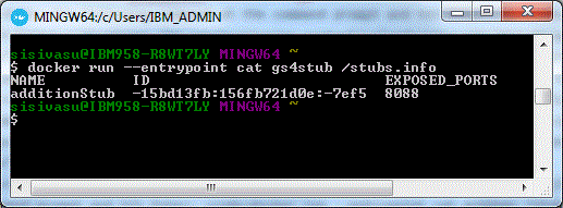

  4. Optional: To verify that it is the additionStub that has been built into the gs4stub image, run the following command:docker run --entrypoint cat gs4stub /stubs.info

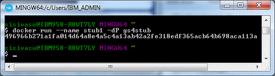

  1. Run the following command:docker run --name stub1 -dP gs4stub
    The long string that is displayed is the unique ID that Docker has assigned to the container in which the stub is running.

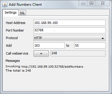

  1. Find the IP address of the Docker machine on which the stub is running. To do so, run the following command:docker-machine ip.
    Note down the IP address, for example, 192.168.99.100.
  2. Open the Add Numbers client.
  3. In the Host Address field, enter the IP address you noted down in Step 1.
  4. In the Port Number field, enter the port number you have noted down in Step 2 of Running the stub in a Docker container, for example, 32768.
  5. Click the equal sign to run the add operation and verify the result.
    Image of the Add Numbers client window.
You have verified that the Add Numbers client is calling the stub running in the Docker container.

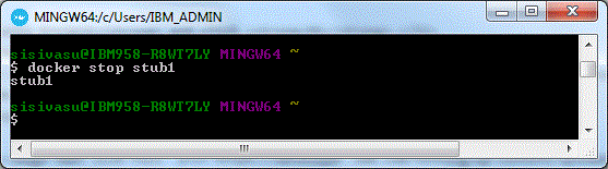

  1. To stop the stub, run the following command: docker stop stub1

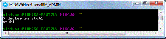

  2. To remove the Docker container, run the following command:docker rm stub1
