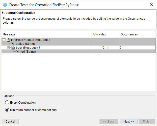

    The Structural Configuration dialog is displayed.
    Image of the Structural Configuration dialog.
    Note: The Binding Configuration dialog is displayed, if the operation that contains the tests has a WSDL as its parent. You must select the binding properties for the message patterns.
  3. Perform the following actions in the Structural Configuration dialog:
    1. Set the number of occurrences for any message element in the Occurrences column.
      You can enter any number from 0 to n.
      Note: The number of structural tests that are generated depends on the availability of choices in the structure of the underlying schema defined for the message.
    2. Select any of the following options that determines the number of structural tests to be generated:
      Option Results in...
      Every Combination A test is created so that every unique combination of occurrences is satisfied. For example, if one element specifies two occurrences and another specifies three, then six tests are generated because there are six possible combinations.
      Minimum number of combinations At least one unique element is generated in a message for each occurrence, but only enough tests are generated to satisfy the highest single occurrence value. For example, if the greatest number of occurrences entered for any element is three, then three tests are generated.
      Note: This is the default option.
    3. Click Next.

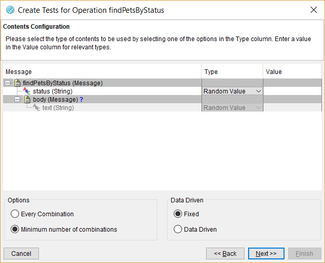

      The Contents Configuration dialog is displayed.
      Image of the Contents configuration dialog.
  4. Perform the following actions in the Contents Configuration dialog:
    1. Select the value in each message element to generate the test according to the element type. The available types that you can select are described in the following table:
      Type Description
      Random Value Generates a random value according to the element type.
      Note: This is the default value for all elements and is available for all field types.
      Constant Populates the field with the name of the parent element in reverse. If required, this value can be modified.
      Note: This is the value that is available for all field types.
      Random Regex Generates a random value that matches the pattern for every instance of the message field. You can enter a regular expression pattern for the value.
      Boundary Generates a value that is on the defined boundary of the field.
      Note: This is the value that is available for numeric field types.
      Beyond Boundary Generates a value that is outside the defined boundary of the field.
      Iterate Enum Generates a unique test for each enumeration.
      Note: This is the value that is available for fields with enumerated values.
    2. Select any of the following options that determines the number of content combinations in the Contract tests to be generated:
      Every Combination Every combination that you specify is selected.
      Minimum number of combinations Uses at least one content combination in the generated Contract test or uses the number of combinations that you specify for any of the message elements.
    3. Select any of the following options in the Data Driven panel:
      Option Description
      Fixed
      Contract tests are generated that are based on the settings set for the content combination. Individual Contract tests are created for each of the content combinations that you specify.
      Note: You must manually set the test data in the generated Contract tests before you run the tests.
      Data Driven
      A single data-driven Contract test is generated based on the content combinations set, with iterations that use the test data. The test data is also generated in an Excel worksheet which is used by the Contract test at run time.
    4. Click Next.

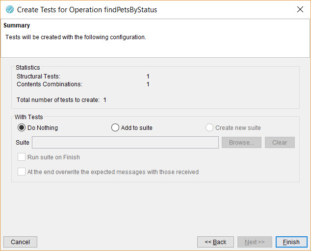

      The Summary dialog is displayed.Image of the Summary dialog.
      You can find the following information that depend on the configurations you set in the previous dialog boxes:
      • The number of structural tests to be generated.
        Note: The number of structural tests to be generated depend on the availability of choices in the structure of the underlying schema.
      • The number of content combinations considered in the Contract tests to be generated.
      • The total number of Contract tests to be generated.
        Note: The number of tests to be generated differ based on the option you select:
        • When the Fixed option is selected, multiple Contract tests are created if different content combinations are specified.
        • When the Data Driven option is selected:
          • A single data-driven Contract test is created if the structural choices in the schema is limited to 1 and you specified different content combinations.
          • A single data-driven Contract test is created for each structural choice that is present in the schema and you specified different content combinations.
  5. Select your action based on the options available in the With Tests panel as described in the following table:
    Option Description
    Do Nothing Creates the Contract tests as displayed in the Statistics panel.
    Add to suite Adds the generated Contract tests to an existing test suite that you select by clicking Browse, and then selecting the existing test suite.
    Create new suite Adds the generated Contract tests to a new test suite, which you must name in the Suite field.
    Note: This option is enabled only if there are more than one Contract tests to be generated. If a single Contract test is to be generated, you can only add it to an existing test suite and cannot create a new test suite.
    Run suite on Finish Runs the new or existing test suite when the MEP wizard closes.
    Note: This option is enabled if you select either the Add to suite or Create new suite option.
    At the end overwrite the expected messages... Overwrites the expected messages with the messages that are received when the Contract tests are run.
    Restriction: This option is disabled when you generate Contract tests.
  6. Click Finish to create the Contract tests and return to the Test Factory main view.
