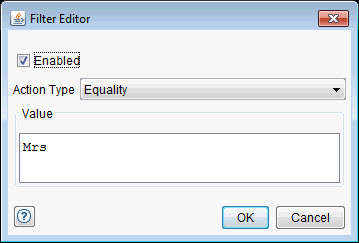

The Filter Editor is displayed.
- Leave the Enabled check box checked to enable the filter, or clear it to disable the filter. By disabling a filter, you can leave it configured in the table but not apply it at run time.
- Select the filter type (Equality or Inequality) from the Action Type combination list. If the type is Equality, all rows that contain the matched filter value can be included in the comparison. If the type is Inequality, only rows that do not match the filter value can be included in the comparison.
- In the field below the Action
Type, enter the wanted filter value, then click OK to
return to the Filter tab. Note: When filters are in use, they are applied first before any other matching is done.
