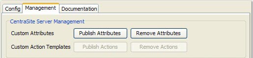

To publish or remove the registry attributes:
Open the CentraSite Server in the Physical
View of Architecture School and select the Management tab.
Click Publish Attributes to

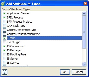

publish HCL OneTest™ API attributes to the registry. If all available
attributes are already published, you are notified. If any available
attributes remain unpublished, however, the Add Attributes
to Types dialog is displayed.
- Select one or more available (that is, unpublished) attributes to publish, then click OK.

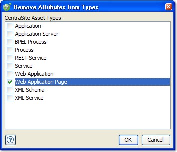

To remove any attributes, click Remove
Attributes. If there are no attributes to remove, you
are notified. If any attributes are published, however, the Remove
Attributes from Types dialog is displayed.
Select one or more previously published
attributes to remove, then click OK.
