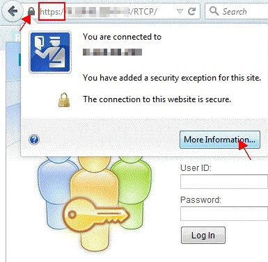

https://myServer:5443/RTCP. - Click the lock symbol shown in the address bar.
- Click More information in the dialog.

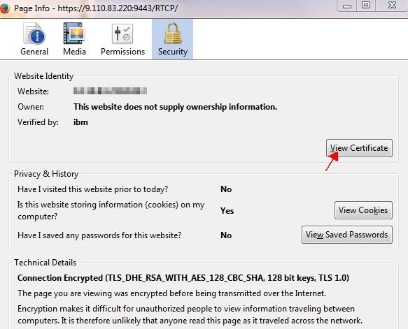

- In the Page Info window, open the Security tab
and click View Certificate.
- In the Certificate Viewer window, open the Details tab and export the "HCL OneTest™ API Root CA certificate".

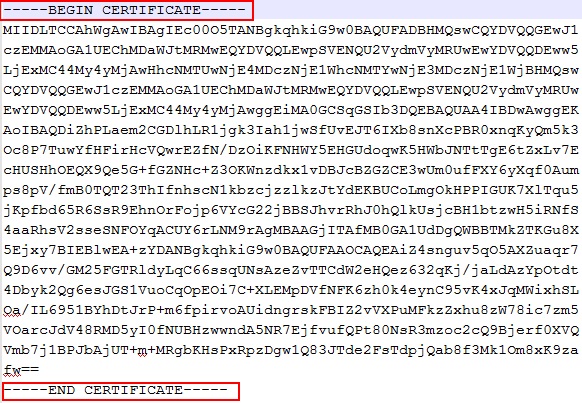

X.509 Certificate (PEM) (*.crt,*.pem). - Click Save. If you open the saved
certificate in a text editor, it looks similar to the following snippet:

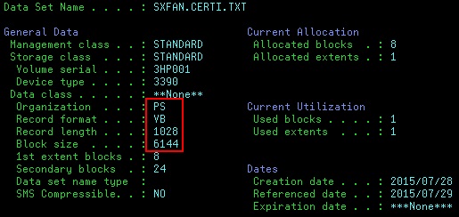

- Allocate a dataset with the parameters highlighted in the
following screen shot:

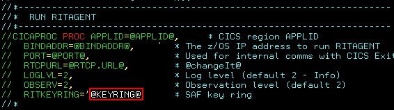

- Set the key ring name in the RITAGENT, changing the value
@KEYRING@to the name of your key ring:
