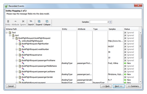

The Entity Mapping screen is displayed.
- On the Entity Mapping screen, map the fields
in the selected recorded events to the data source to use for data
model-driven stubbing.
A separate Entity Mapping screen is displayed for each event you selected in step 1. The following table describes how to use the Entity Mapping screen.
To... Do this... Specify that a field in a recorded event will be an entity in the data model - Select the field.
- Click Entity. The Map to entity dialog box is displayed.
- Click OK. For the selected field,
Newis displayed under Status.
Specify that a field in a recorded event will be an attribute of a particular entity in the data model - Select the field.
- Click Attribute. The Map to Attribute dialog box is displayed.
Specify that a field in a recorded event is not included in the data model - Select the field.
- Click Ignore.
Search for a specific data item in a recorded event - Click Search.
- In the Find field (displayed at the bottom half of the screen), enter the search query.
- Press Enter.
Increase or decrease the number of example values displayed for each field In the Samples field, enter or select the number of examples to display (default value: 2).Specify that a field is a "key" field so that it can be used to match data between different messages Under the Key column, select the check box of the field. Expand or collapse a node - Click the node.
- Click Expand or Collapse.

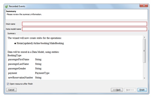

- On the Summary screen, review the configuration of the
stub and save the stub and the data model.
Click Finish.

- If you open the Data Models window in the Architecture School perspective, the newly created data model is listed on the upper left of the window. To display the data models details in the window, select the model.
