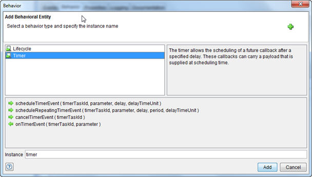

Add Behavioral Entity dialogThe upper left side of the Add Behavioral Entity dialog displays the available behavior-types. The upper right side of the Add Behavioral Entity dialog displays a description for each selected behavior-type.
The default available behavior-types are as follows:
  • Lifecycle, which you can use to perform certain actions when the stub starts or stops.
  • Timer, which you can use to set a timer for the stub.
The lower half of the Add Behavioral Entity dialog displays the available sample behaviors for the currently selected behavior type. The Instance field is used to refer to the behavioral entity in function actions. This field is optional so that you can create multiple instances of a behavior. Based on the selected behavior, a default instance name is displayed. If required, you can specify a different instance name.
The following sample behaviors are listed:
  • Functions: The functions are indicated with the right arrows functions and can be called within the function script in the business logic view of the stub events. The three functions that can be called within scripts are scheduleTimerEvent, scheduleRepeatingTimerEvent, and cancelTimerEvent.
  • Events: The events are indicated with the left arrows functions and can be selected in the Events tab to perform business logic or send a message when the event occurs. The callback that is named onTimerEvent, provides an event to the stub when a timer runs out.

An example of calling a Function Action from the logon event for setting a timer to log out the user from a session after a specified time period.
logoffTimer.scheduleTimerEvent("logOutSession", tags["SESSION/KEY/sessionID"], 30, java.util.concurrent.TimeUnit.SECONDS)
In this example:
  • logoffTimer is the name of the instance. This instance must be added to the onTimerEvent, which is displayed as logoffTimer.onTimerEvent to the Events tab and runs after the specified time period elapses.
  • The value of tags, ["SESSION/KEY/sessionID"], is evaluated at the point when the timer is started and is passed as the parameter to the event's input tab.
  • logOutSession is the identifier for this timer that is passed to the Input tab of the onTimerEvent event.
  • logOutSession identifier can also be used as a parameter of the cancelTimeEvent function to cancel the timer
