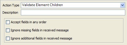

If you want to validate the children of the selected field, select the Validate Element Children option. This is available only for XML messages. Validate Element Children Select the additional options, as follows:
Accept fields in any order HCL OneTest™ API ignores the order in which message fields are received. This option can be useful since messages sent on certain transports can undergo field-reordering.
Ignore missing fields in received message When enabled, any fields present in the expected message structure but absent in the message that is received do not cause invalidation.
Ignore additional fields in received message When enabled, any fields present in the received message but absent in the expected message structure do not cause invalidation.

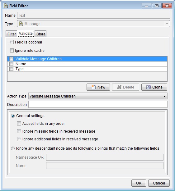

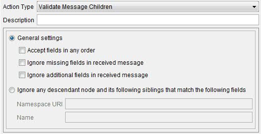

If you want to validate the children of a message element, select the Validate Message Children option. Validate Message Children Configure the General settings as follows:
Ignoring the descendent nodes and its following siblings
When you keep adding extra fields to a schema, the messages change; consequently, the validation fails. Select Ignore any descendant node and its following siblings that match the following fields check box to ignore any descendent nodes or siblings to the messages added after the node indicated by the following parameters:
  • Namespace URI (optional): Enter the namespace URI that you have created for the fields to be ignored.
  • Name: Enter the name of the field.

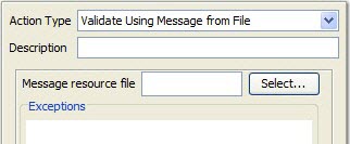

To enable validation against a saved message file, edit the message in the subscribe step and double-click the top (Message) node of the message. Next, select the Validate Using Message from File action type.
Validate using message from file

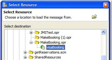

Click Select to choose a message resource file. Select the wanted message from the Select Resource dialog and click OK when finished.
Select resource
The message location is displayed as a path in the field editor (for example, /Test Data/Output Data/myMessage.)

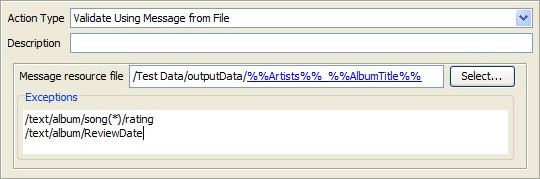

If you are not interested in comparing some of the fields (for example, date fields, which are likely to change), validation exceptions can be added. Paths to fields that are not to be included in the validation must be entered in the Exceptions field.
In the example that is shown, validation is not carried out against the ReviewDate attribute or against any of the rating elements for each of the songs.

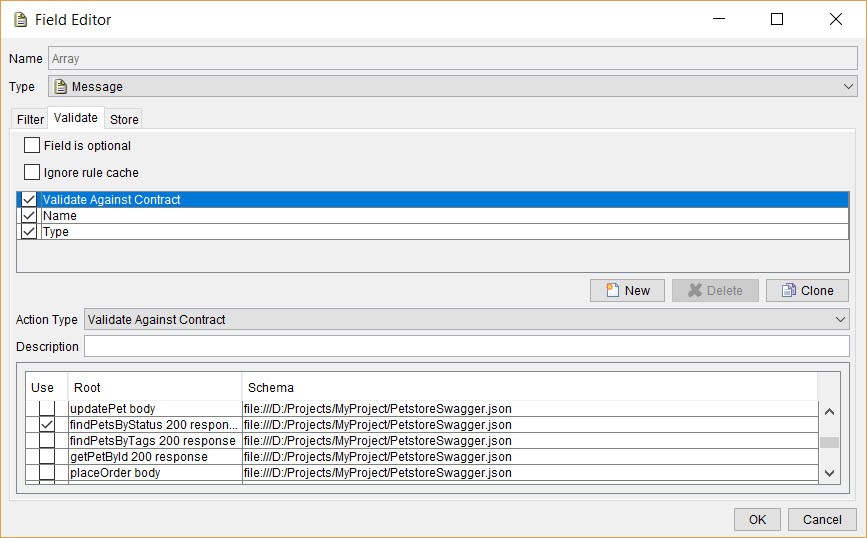

It is possible to validate a message against a contract. To be able to validate against a contract, you must have defined a schema for the message and selected a root in the schema. The contract is adhered to when the schema in the incoming message matches the schema defined for received messages. If the validation fails the contract is rendered as broken or invalid.
When you configured the MEP for an operation, if you selected a schema and a root for the Reply or Subscribe action, the value of the validate action for the message elements is automatically assigned as Validate against contract. The selected root and the location of the schema defined for the message is displayed.
Image of the Field Editor showing the value for validate against contract
You can opt to change the Root in the schema for specific message elements. You can also select multiple roots in the schema to validate the contract.
