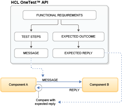

In HCL OneTest™ API, tests generally consist of one or more inputs into the systems under test (SUT), and then validation of results and side effects. Data from one step of a test can be used to feed the next step. HCL OneTest™ API is built for testing, so every test step can be validated without scripting.
The test execution process consists of the following steps:
  1. Create test steps that include a send message action and a receive message action.
  2. Set the expected message outcome in the receive message action.
  3. Trigger the send message action that is, sending the message or messages to the SUT.
  4. Capture the reply from the SUT.
  5. Validate the received message against the expected message and point out any differences.
