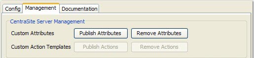

  1. Open the CentraSite Server in the Physical View of Architecture School and select the Management tab.

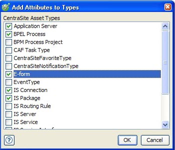

  2. Click Publish Attributes to publish HCL OneTest™ API attributes to the registry. If all available attributes are already published, you are notified. If any available attributes remain unpublished, however, the Add Attributes to Types dialog is displayed.
  3. Select one or more available (that is, unpublished) attributes to publish, then click OK.

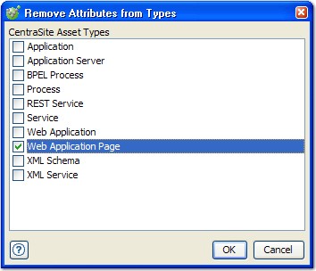

  4. To remove any attributes, click Remove Attributes. If there are no attributes to remove, you are notified. If any attributes are published, however, the Remove Attributes from Types dialog is displayed.
  5. Select one or more previously published attributes to remove, then click OK.
