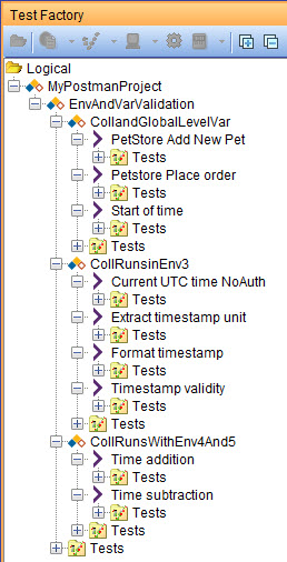

If you completed the migration, the Test Factory view is displayed with the tests that were created. An example follows:
Image of the Test Factory view with the migrated Postman collection
  1. Select the test or stub that you want to run.
  2. Right-click the test or stub and select Run.
    The selected test or stub runs, and the Test Lab view is displayed with the results of the run.
