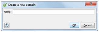

click Create new domain in the Domain list.
The Create a new domain dialog is displayed.
In the Name field, enter the name of the new domain.
Click OK.
The Create a new domain dialog is closed and the new domain is selected in the Domain list.
