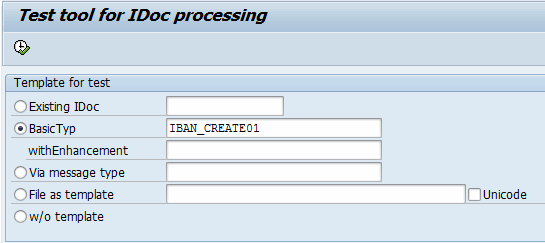

    2. Enter an IDoc type in Basic Type.
      Test tool for processing

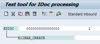

      This provides you with a structure to edit:
      Structure to edit

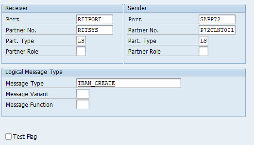

  3. Double-click EDIDC and E1IBAN_CREATE to edit the control record fields:
    Edit control record fields

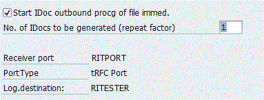

  4. Click Standard Outbound Processing to send the message.
    Standard outbound processing

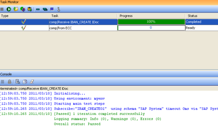

  5. To receive the IDoc in HCL OneTest™ API, run a test that is configured to subscribe to SAP:
    Run a test

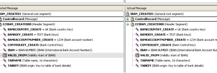

  6. Click the Subscribe line to display the message differences window:
    Message differences window
