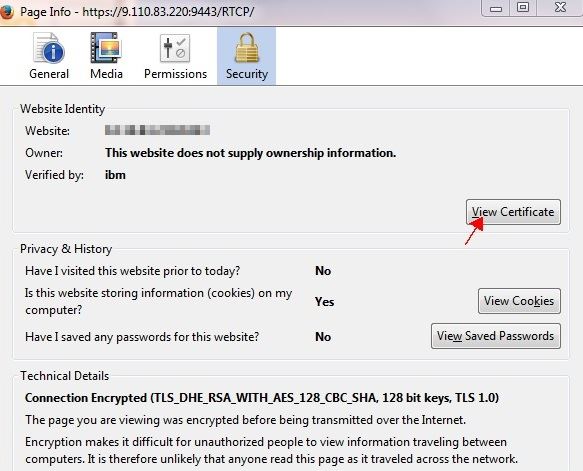

  5. In the Page Info window, open the Security tab and click View Certificate.

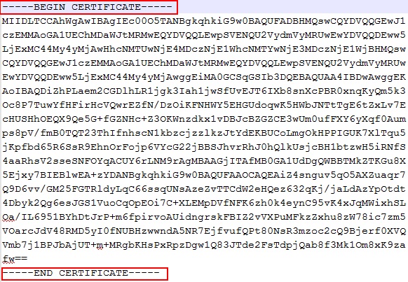

  8. Click Save. If you open the saved certificate in a text editor, it looks similar to the following snippet:
The HCL® Quality Server server certificate is exported to a file.

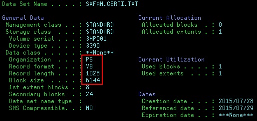

  1. Allocate a dataset with the parameters highlighted in the following screen shot:

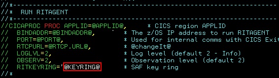

  7. Set the key ring name in the RITAGENT, changing the value @KEYRING@ to the name of your key ring:
You have configured the CICS® Distributed Program Link (DPL) Agent to use HTTPS. You can now define resources and start the CICS Transaction Server Agent.
