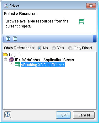

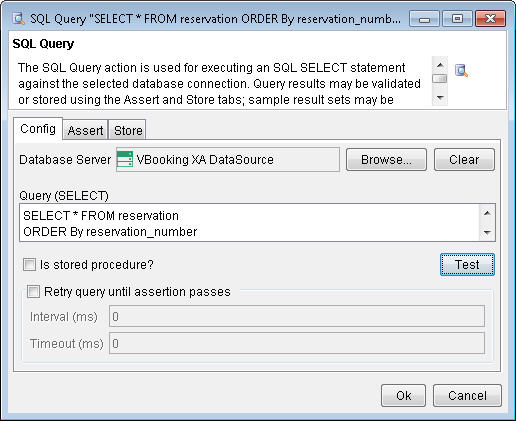

  1. Select a database resource from the available resources in the project by clicking Browse.
    The initial list of databases is derived from the information that is provided in the Architecture School perspective. If the operation that you are creating a test for has a dependency on a database, then that database shows in the list when Obey References is set to Yes. If you want to work with a database where there is no dependency link to the current operation, all databases in the project can be viewed by setting Obey References to No.
    Select a Resource
  2. Enter a query (that is, a SELECT statement or stored procedure call) in the Query (SELECT) field.
    SQL Query Action dialog
  3. If you are entering a stored procedure, click the Is stored procedure? check box and modify the syntax of the query, for example, {call procedure (var, var)}.
    Tip: If you are using a stored procedure call, you might want to use the Stored Procedure action instead (see Adding a Stored Procedure action to a test). This action presents the available functions and input and output parameters more clearly.
  4. To have the test action repeat the validation attempt, click the Retry query until assertion passes check box and set the Interval and Timeout options. A validation attempt might be needed where database writes are performed by another process that is running asynchronously to HCL OneTest™ API, and if the query runs before the data is committed. The query is tried every [Interval (ms)] until [Timeout (ms)] is reached.
  5. Save the SQL Query action by clicking OK.

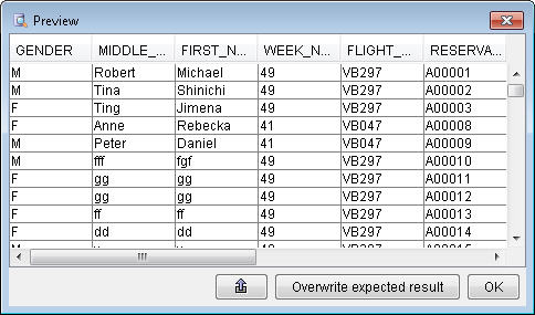

  1. To run the query and retrieve the data without running the test, click Test.
    The results of the query are displayed and any returned data is shown in the Preview dialog. Preview
    Important: If the query was canceled before it finished, any data that was built before it was canceled is displayed.
  2. The data that is retrieved by running the query now can be reused to validate the data that is returned by the query when it is run as part of a test. To do this, click Overwrite expected result; it is then used to fill in data on the Assert and Store tabs. Otherwise, click OK to return to the SQL Query action without copying any data.

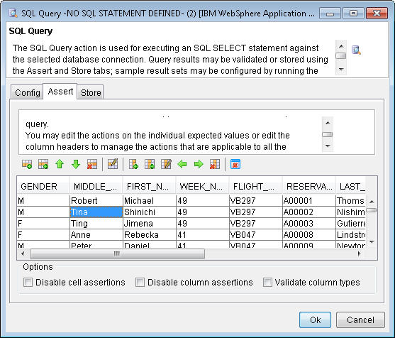

If you did not run a test query and save the results, you can add data from the Assert tab or Store tab, by using the icons.
If you ran a test query and saved the results, the column headings (and data) are displayed in the Assert tab and Store tab, and the rows, columns, and cells can be edited and arranged by using these same icons above the data. To see what an icon does, hover over it.

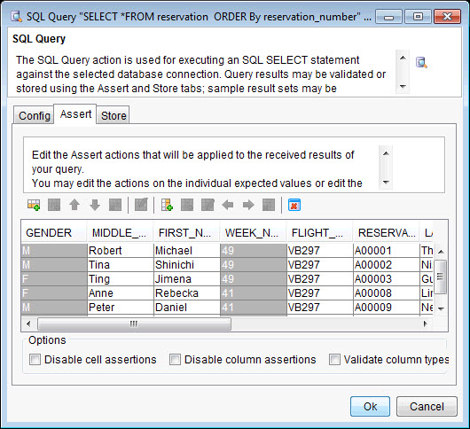

Validating query results
To change the validation rules for a cell or column, use the Assert tab. Column assertion validates that all cells in a column match the rule for that column. For example, you might want to assert that all cell values for that column match a certain regular expression. Cell assertion validates that a specific cell for that column matches the rule set for that cell. You can use both cell and column validation rules. For example, you might want to assert that all values in the column contain 4 digits and that a specific cell contains the value 1234.
  1. Customize the validation options by using options that are described in the following table. If assertions are disabled, assertions can still be created and modified, but they are not used, including the comparison between the number of rows that are expected and the number received.
    Important: Cells with no enabled Assert actions are shown in gray. Cells with enabled assert actions are turned on by default. When you edit a cell, by default the validation is an Action Type of Equality and it is turned on. However, when you edit a column, the default validation, Action Type of Equality is turned off. If you want to use the default column validation or change that validation to another action type, you must turn it on.
    Option Definition
    Disable cell assertions To disable cell assertions, click the Disable cell assertions check box. This selection disables any assertion actions that exist in the cells. When this option is selected, column assertions are used.
    Disable column assertions To disable column assertions, click the Disable column assertions check box. This selection disables any assertions that are made on any received value, independent of the cell assertions. When this option is selected, cell assertions are used.
    Validate column types To validate column types, click the Validate column types check box. This selection validates any data types that are made on any received value, independent of the cell types. When this option is selected, column data types are validated.

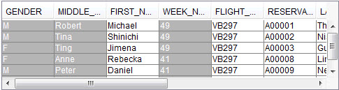

  2. Customize the validation options further by enabling or disabling cell assertions on a column by column basis. Some examples are shown.
    Validate actions are disabled for all cells in GENDER and WEEK_NUMBER and enabled for all cells in the other columns.
    Disable cells per columns

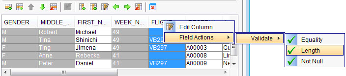

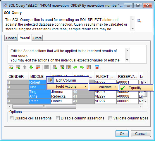

    By selecting the Field Actions menu on a column, you can see that all cells in that column have an enabled Equality action.
    Field actions menu for a column
    When you click Field Actions > Validate > Equality the validation of all cells in the column are disabled.

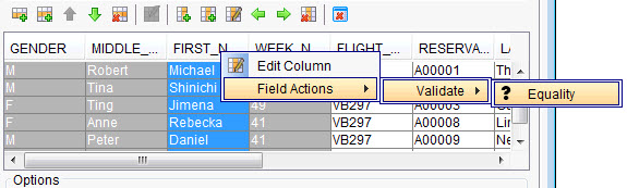

    If some cells in a column are enabled with the Equality action and other cells are disabled, you see Field Actions > Validate > ? Equality when you select the Field Actions menu.
    Field actions menu with some cells enabled and some cells not enabled
    If some cells in a column are enabled with the different Assert actions, you can see those actions when you select the Field Actions menu.
    Field Actions menu with different cell Assert actions.

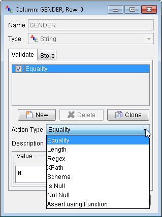

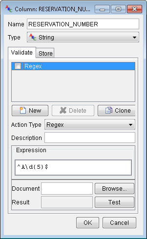

  4. Edit the validation rules for a column. Select any cell within the column and click Edit Column (Edit Column icon) or right-click the column heading and select Edit Column.
    When you are editing a column, the field editor opens. You can then change the validation rules for the column. By default the validation is an Action Type of Equality.
    In this example, the check box next to Equality was not selected. Instead, Regex was selected from the Action Type list and enabled by selecting the check box next to Regex. The Expression field contains an expression to validate that the reservation number is in the format A followed by five digits. This validation rule can be checked by using the Document field and clicking Test.
    Edit Column dialog

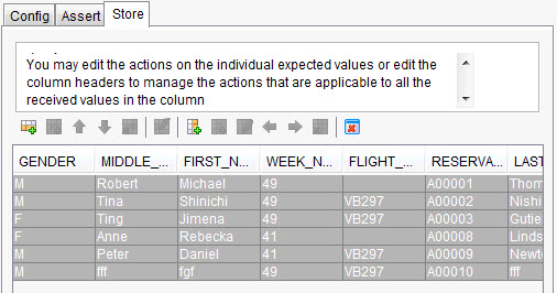

Storing the return value in to a tag
You can store the values in a tag, either as a list or as a single value. When you edit a column, all the values for that column are stored in the specified tag as a tag list. When you edit a cell, a single value for that cell is stored in the specified tag. For more information about storing data in to a tag, see The Field Editor.
To store the values for a column or the value for a cell in a tag for later use, use the Store tab. For example, you might want to set the value of the tags in the test to the values of each column in the data source.

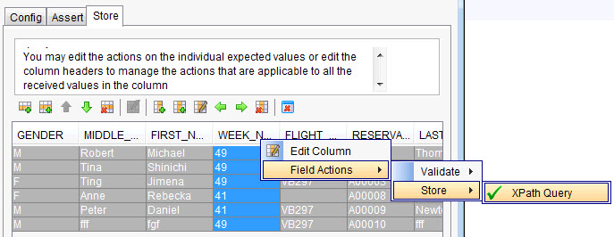

Important: Starting in 9.2.0.1, you can use the column's Field Actions menu to set the enabled state for the Validate and Store actions of its cells. Note that both classes of actions can be accessed in both the Assert and Store tabs.
Field actions menu for the Store tab
In addition, cells with no enabled Store actions are shown in gray.
Disables store actions
  1. To store a value from a selected cell in to a specified tag, click Edit Cell (Edit Cell icon) or right-click the cell and select Edit Cell.
  2. Click the Store tab.
  3. Click New.
    The Field Editor opens. By default the value is an Action Type of Copy, and the tag is set to whatever value you set for the tag within that field. For more information about the Field editor and the other Store tab options, see The Field Editor.
    Store tab dialog
  4. Type the name of a tag (new or existing) or select a tag from the list, and click OK.

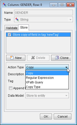

  5. To store the values for a column in to a specified tag as a tag list, click Edit Column (Edit Column icon) or right-click the column heading and select Edit Column.
  6. Click the Store tab.
  7. Click New.
  8. Type the name of a tag (new or existing) or select a tag from the list, and click OK.
