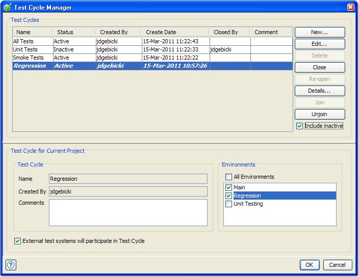

Test cycle manager
Test cycles are managed in the Test Cycle Manager window, available by right-clicking the test cycle status indicator and selecting Manage from the menu, or by selecting Project > Test Cycle > Manage from HCL OneTest™ API main toolbar.
Test cycle manager
The Test Cycle Manager displays a list of all test cycles and their details, as follows:
Name The name of the test cycle, provided when the test cycle was created. The name can be modified when you are editing the test cycle.
Status Active indicates that the test cycle is open and can be joined to the current project. Inactive indicates that the test cycle was closed, and it cannot be edited or joined to the project until opened again.
Created By The ID of the user that created the test cycle.
Create Date The date and time when the test cycle was created.
Closed By If closed, the ID of the user that closed the test cycle.
Comment Displays any comments that were added to the test cycle when created or edited.
If the current project is associated with one of the listed test cycles, its entry in the list is displayed in bold and italicized type.
By default, only active test cycles are displayed in the Test Cycle Manager. To show all test cycles, including test cycles that were closed, enable the Include inactive option to the right of the Test Cycles table.
Regardless of which test cycle is selected in the list, the details of the current projects test cycles are displayed in the lower portion of the window. The details that are shown are the test cycle to which the current project is associated (joined).

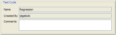

The Test Cycle panel displays the test cycle name, who created the test cycle, and any comments that were added.

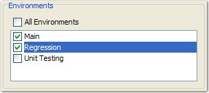

The Environments panel displays which environments in current project are active within the test cycle. Results are stored only for tests that are executed within selected (active) environments.
Environments
By default, the All Environments option is enabled when a project is joined to a test cycle. To use only a subset of the current projects environments, disable the All Environments option and check the box next to one or more wanted environments.
Note: If an environment is not enabled and is selected in HCL OneTest™ API, the Test Cycle icon indicates that the test cycle is paused.
