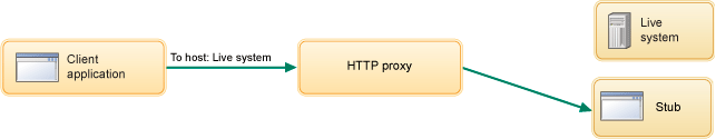

- HTTP proxy with virtualizationIn HTTP proxy with virtualization, the stub is running, so the request is forwarded to the stub. Depending on the configuration of the stub or the configuration of the proxy, the proxy might take one the following steps:
- Forward all traffic for the requested host to the stub
- Filter the traffic based on other parts of the message, such as the path of the URL or the HTTP header values
Figure 3. HTTP proxy with virtualization

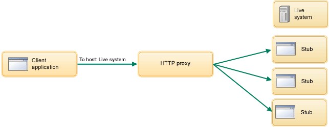

When there are multiple instances of the stub for the transport or operation that have the same routing rules that are running, then the HTTP proxy routes the requests to the stub instances by using a round-robin algorithm. See HTTP proxy forwards to a stub when multiple stubs exist.Figure 4. HTTP proxy forwards to a stub when multiple stubs exist

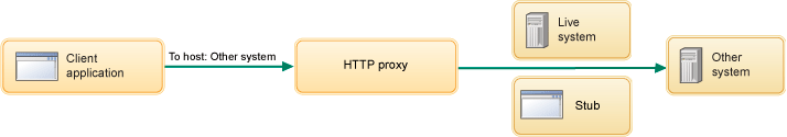

- HTTP proxy forwards to other systemIf the system under test specifies a host other than the live system, the traffic does not match the rules that the stub has set up in the proxy. The traffic is, therefore, forwarded to the specified "other" system, as shown in HTTP proxy forwards to other system. You can see those rules on the Network Dashboard in HCL® Quality Server. For more information, see Viewing running agents.
Figure 5. HTTP proxy forwards to other system

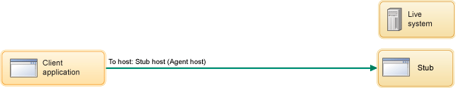

- Direct connection to stub
Another alternative is to configure the system under test to connect directly to the stub (see Direct connection to stub). This process requires assigning a fixed port number to the transport that the stub uses.
To do so, take one of the following actions:- Go the Logical view of the HCL OneTest™ API Architecture School perspective, right-click the HTTP connection resource, and click Open physical resource.
- Go the Physical view of the Architecture School perspective and double-click the web server resource.
On the Server page, Server Socket Overrides section, enter a number for the Port field that does not conflict with anything on the host where the stub will run. That host is one of the following servers:- The server where HCL OneTest™ API is running
- If running through HCL® Quality Server, the server where the HCL OneTest™ API Agent is running
For more information about socket overrides, see Creating physical web server resources.
Next, configure the system under test to use as its endpoint the host and port number of the server where the stub will run, rather than using the host and port for the live system. Be aware of the following limitations:- As with the reverse proxy, this method does not work if the responses from the stub contain absolute URLs.

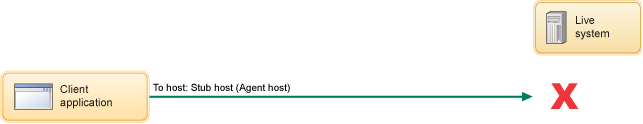

- This method does not route messages dynamically. When the stub is not running, connections fail (see Direct connection to stub that is not running).
- All traffic for the specified endpoint is routed to the stub. This method does not filter the traffic based on operations.
- If the stub is running, it can perform pass-through to the live system, with the following limitation. If the operation stub settings define that paths, method or headers are filtered, then the path, method, and headers in the request must match the filter. If they do not match, the stub is not invoked, an error response is returned to the client, and pass-through does not occur. If the stub is not running, then connections fail.
- With other methods, you can have multiple Agents and the stub can run on any Agent that is registered with HCL® Quality Server for the correct environment. With this method, if running through HCL® Quality Server, you must configure the system under test to use the exact machine on which the Agent runs the stub.
Figure 7. Direct connection to stub
Figure 8. Direct connection to stub that is not running
