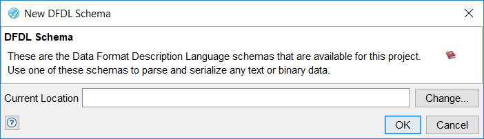

  1. In the Schema Library view of the Architecture School perspective, click the arrow next to the Add button, then click Other > DFDL Schema.
    The New DFDL Schema window is displayed.
    The New DFDL Schema dialog box.
