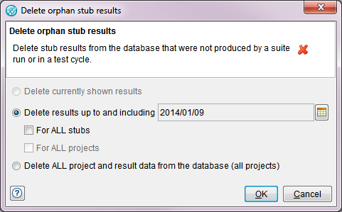

The results of one or more stubs can be deleted from the results database directly within the Results Gallery or from the command line.
- To delete only the selected results (that is, the results selected from the current stub), enable the Delete currently shown results option.
- To delete multiple result sets for the selected
stub, enable the Delete results up to and including option.
Enter the date for which all results and all earlier results are to
be deleted. You can use wildcard options to delete a broader range
of data:
- For ALL stubs, you can delete results for all stubs before and including the selected date.
- For ALL projects, you can delete all stub results in all projects within the database before and including the selected date.
For more information on the commands that delete orphan stub results, see Deleting historical test results data by using the command line
