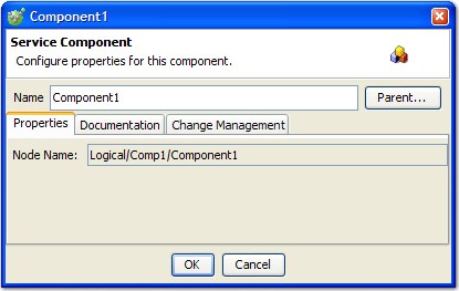

Viewing the component details
- Double-click the component or right-click
it and select Open from the menu. The component
editor is displayed.
- The component name is displayed, with more
information in various tabs, as follows:

Changing a component name
- Use the component editor or use the Rename
option.
- To open the component editor, double-click the component or right-click it and select Open from the menu. Enter a new name for the component in the Name field.
- Right-click the component, select Rename from the menu, and enter a new name for the component in the Rename to dialog.
Note: The rename check is case-insensitive. If you only change the capitalization of the resource name, the OK button in the Rename dialog box is not enabled. - Click OK to save your changes and close the editor/dialog.

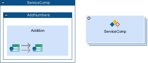

Expanding and collapsing components
You can view Service components in an expanded (default) or collapsed state.
To change the current state of a component, simply click the expand/collapse icon (in the title bar). The image illustrates the same component in its expanded and collapsed states:
