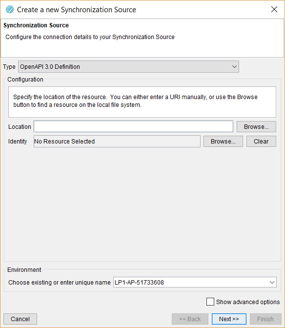

Perform the following steps in the
Create a new Synchronization Source dialog box:

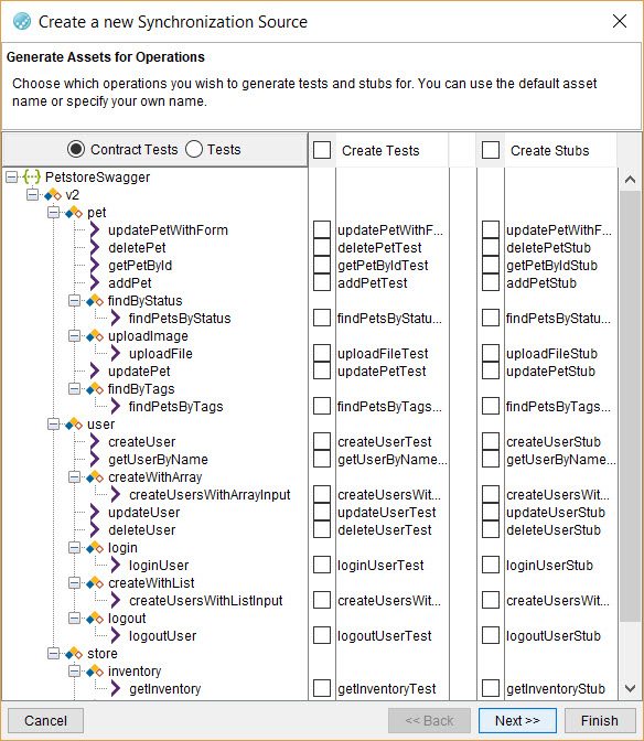

- Select any of the following actions that depends on the type of Contract testing you want to perform in HCL OneTest™ API:
Perform the following steps in the Generate Assets for
Operations dialog box:

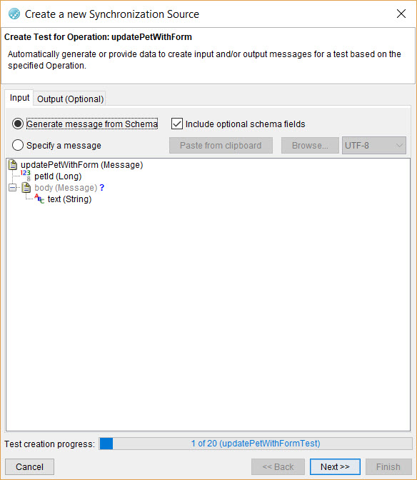

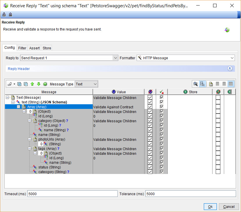

Verify whether the test is a Contract test by performing the following steps:
- Click the test in the Test Factory view to open the test steps in the Test Lab view.
- Click the Reply or
Subscribe action.The message is displayed in the Message Editor.
- Check if any of the message elements have a value as
Validate Against Contract.
If any of the message elements display this value, then the test created is a Contract test.
