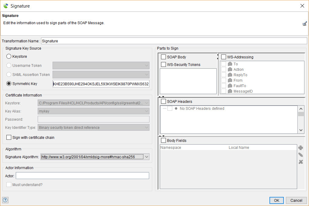

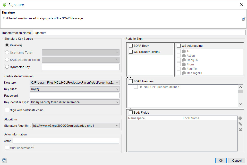

Note: The default keystore uses the asymmetric key-based signature algorithm to sign the outgoing messages and the Keystore option is selected. - Perform any of the following actions:
Perform the following steps to use the asymmetric key-based
signature algorithms to sign messages:
Perform the following steps to use the symmetric key-based
Configure the following settings:
Option Action SOAP Body Select this check box to sign the body of a SOAP message. Note: In the Signature window, only message elements that are explicitly selected will be signed.WS-Security Tokens Select this check box to sign other security actions listed above this action (under the toolbar on the WS-Security tab) for a SOAP message. For each action displayed under this check box, you must select the check box next to it if you want to sign it. WS-Addressing Select this check box to encrypt WS-Addressing fields of a SOAP message. For each field that is displayed under this check box, you must select the check box next to it if you want to encrypt it. SOAP Headers Select this check box to sign individual header elements in the SOAP envelope. You must select the header element that you want to sign. Body Fields Add a qualified name for each body element that you want to sign in the SOAP envelope. -
Perform the following steps:
- Click OK to save and close the Signature dialog box.
- Click OK to save and close the Field Properties dialog box.
- Click OK to save and close the Message Editor dialog box.
You have configured the outgoing SOAP messages to use asymmetric or symmetric key-based signature algorithms to sign the messages.
