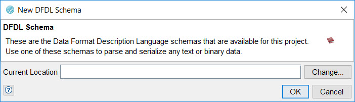

The New DFDL Schema window is displayed.
In the New DFDL Schema window, click
Change.
- In the Select Location dialog box, enter a full path to the file that contains the DFDL schema or click Browse, browse to the file, and click Open.
- Click OK when the correct path is displayed.
You have created a DFDL schema and added the schema to the schema library. The DFDL Schema Library lists the path to the created DFDL schema file.
