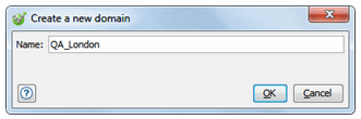

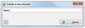

  4. Under HCL® Quality Server, click Create new domain in the Domain list.
    The Create a new domain dialog box is displayed.
  5. In the Name field, enter the name of the new domain.
  6. Click OK.
    The Create a new domain dialog box is closed and the new domain is selected in the Domain list.
