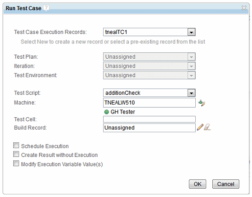

  5. Click the Run Test Case icon above the list of test cases.
    The Run Test Case dialog is displayed.
    Run Test Case
  6. If wanted, modify the available execution and results options, then click OK to execute the test case.
    Note: The Test Script option can be used to select which test script (that is, which environment) is used when the test case is executed.
