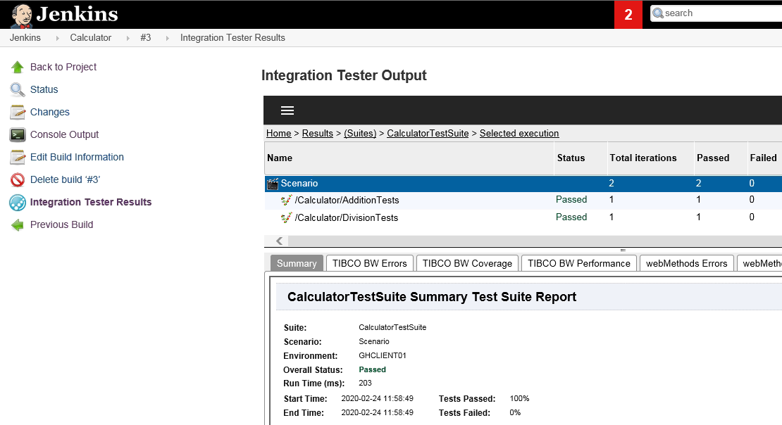

  1. Click Build Now by selecting the relevant job in Jenkins.
  2. Verify that the project has been rebuilt under the Build History option.
  3. Select the most recent build for the job under Build History.
  4. Click the Integration Tester Results link on the left pane.
    runtests
An output page is shown with a HCL® Quality Server results page embedded. The relevant test suite results are displayed.
