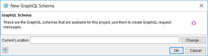

  1. Click the arrow next to the Add button in the Schema Library view of the Architecture School perspective, and then click Web > GraphQL Schema.
    The New GraphQL Schema dialog box is displayed.
    New GraphQL dialog box
