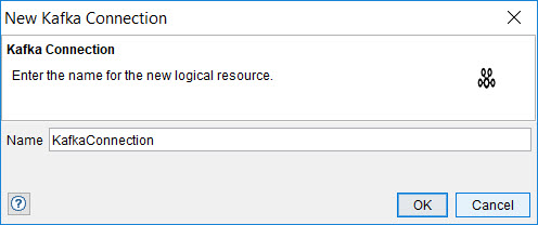

The New Kafka Connection window is displayed.
Enter a name for the connection in the Name field.
Click OK.
