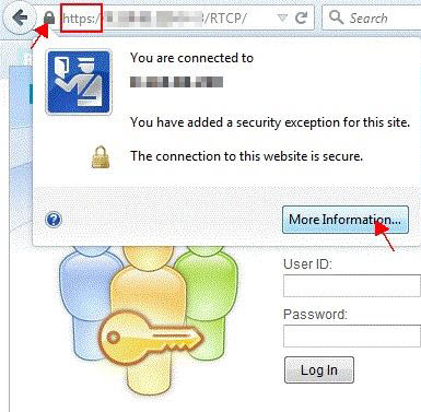

  3. Click the lock symbol shown in the address bar.
  4. Click More information in the dialog.

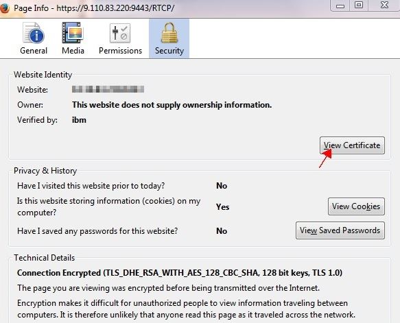

  5. In the Page Info window, open the Security tab and click View Certificate.

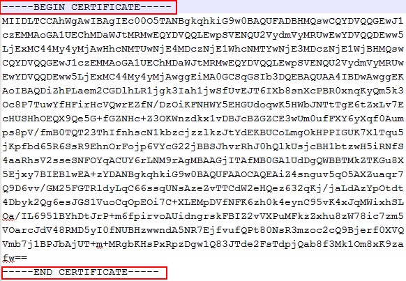

  7. In the Save Certificate To File dialog, select PEM against Save as type. For example, X.509 Certificate (PEM) (*.crt,*.pem).
  8. Click Save. If you open the saved certificate in a text editor, it looks similar to the following snippet:

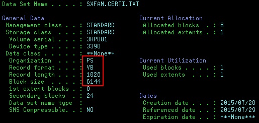

  1. Allocate a dataset with the parameters highlighted in the following screen shot:

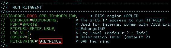

  7. Set the key ring name in the RITAGENT, changing the value @KEYRING@ to the name of your key ring:
