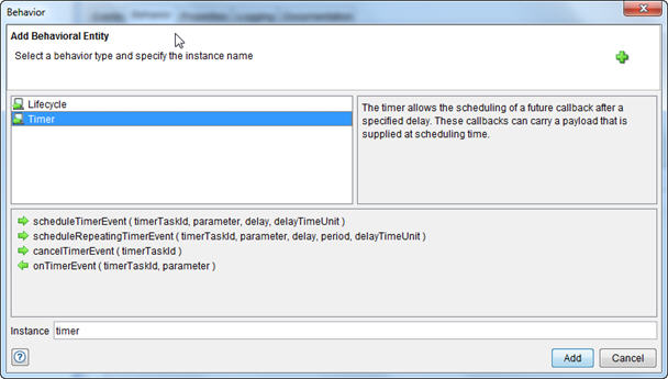

Add Opens the Add Behavioral Entity dialog box.
Add Behavioral Entity dialog boxThe upper left side of the Add Behavioral Entity dialog box displays the available behavior-types. The upper right side of the Add Behavioral Entity dialog box displays a description for each selected behavior-type.
The default available behavior-types are as follows:
  • Lifecycle, which you can use to perform certain actions when the stub starts or stops.
  • Timer, which you can use to set a timer for the stub.
The lower half of the Add Behavioral Entity dialog box displays the available sample behaviors for the currently selected behavior type. The Instance field is used to refer to the behavioral entity in function actions. This field is optional so that you can create multiple instances of a behavior. Based on the selected behavior, a default instance name is displayed. If required, you can specify a different instance name.
The following sample behaviors are listed:
  • Functions: The functions are indicated with the right arrows functions and can be called within the function script in the business logic view of the stub events. The three functions that can be called within scripts are scheduleTimerEvent, scheduleRepeatingTimerEvent, and cancelTimerEvent.
  • Events: The events are indicated with the left arrows functions and can be selected in the Events tab to perform business logic or send a message when the event occurs. The callback that is named onTimerEvent, provides an event to the stub when a timer runs out.

Tip: To select multiple behaviors for a behavioral entity, hold the Ctrl key and click each behavior after you select a behavior-type on the upper left side of the Add Behavioral Entity dialog box.
After you specify the properties of a behavior, click Add to create the behavior and to close the Add Behavioral Entity dialog box.
Tip: Although behavioral entities display on the list window on the upper left side of the Behavior tab, each new behavioral entity also has its events (qualified by the name of the behavior instance) available as values in the Events field on the Events tab for the stub. For more information, see The Events tab.
