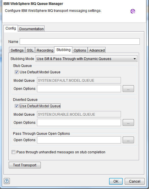

By using the Stubbing tab, you can specify the stubbing settings.
The Stubbing page of the MQ transport.

Stub Queue, Diverted Queue areas
Sift-and-pass-through for WebSphere® MQ requires two queues: a stub and a diverted queue. Both of these queues are created automatically in dynamic mode but needs to be created in fixed mode.
  • Stub queue: This is the queue from which the stub will consume messages.
  • Diverted queue: This queue holds the details of messages that have been diverted so that they can be forwarded to the live system if the stub deems it necessary.
If Use Sift & Pass Through is clicked in the Stubbing Mode list, you can:
  • Dynamic mode: Configure the model queues used to create the queues that are required to configure sift-and-pass-through (the defaults are configured, but it is possible to override these).
  • Fixed mode: Configure the suffix that is used for the stub and the divert queue.
  • Specify how messages that are not dealt with by a stub should be handled. The options are to either discard them (default) or pass through to the "real" queue.

Model Queue for Dynamic mode (Stub, Diverted queues)
In Dynamic mode, the stub queue should be created from a model queue that creates a temporary dynamic queue. This is because only the stub needs to be able to read from this temporary queue, which must be deleted when the connection is closed.
The diverted queue should be created as a permanent dynamic queue because multiple connections need to be able to read from, and write to, it.
When a queue manager is created, suitable model queues are created:
  • SYSTEM.DEFAULT.MODEL.QUEUE is used as the default to create the stub queue.
  • SYSTEM.DURABLE.MODEL.QUEUE is used as the default for creating the diverted queue.
HCL OneTest™ API uses temporary queues for recording.
Select the Use Default Model Queue check box (by default, it is selected) if you want to specify SYSTEM.DEFAULT.MODEL.QUEUE or SYSTEM.DURABLE.MODEL.QUEUE (as applicable) as the object from which to copy attributes.
If you want to specify a different model queue, clear the Use Default Model Queue check box and enter a queue name in the Model Queue field.

Suffix for Fixed mode (Stub, Diverted queues) You must manually create the stub and the divert queues with appropriate suffix before running the stub. By default, .STUB and .DIVERT suffix is used by HCL OneTest™ API for identifying these queues, which can be changed, if required.
For example: To run a stub using queue Q1, you must manually create Q1.STUB and Q1.DIVERT before you run the stub.
Open Options (Stub, Diverted, Pass Through queues)
You can override default options when opening the queues. To specify a different open options:
  1. Click to select one, or more, open options that are supported for the operation.
  2. Click OK. The selected open options are converted into a decimal value, which is displayed in the field.
Pass through unhandled messages on stub completion
To pass the queue messages that were not handled by the stub to the "real" queue, select this check box.
Clear this check box to discard the queue messages that were not handled by the stub.
