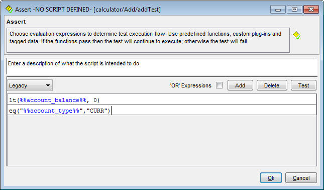

The Assert action is a conditional action that allows you to construct a list of expressions that determine whether a test proceeds. If the Assert action passes, the test continues. If the Assert action fails, the test fails and no further test actions are performed.
Assert action window
Expressions can be written in any of the following forms:
  • Chai
  • ECMAScript (such as JavaScript)
  • Legacy functions
  • Other scripting languages (requires customization)
Expressions must evaluate to true or false. Any other result causes the test to fail with a console message that identifies the non-boolean result.
To enter an expression, click Add and type into the empty input field. To remove an expression, select it and click Delete. To test the expressions, click Test and enter temporary values for any tags shown.

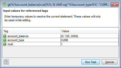

You can use list tags in these expressions. When you click Test, you must supply the complete list of values for the list tag, enclosed in braces.
The value for account_balance is an array, enclosed in braces.
For more information about list tags, see Repeating elements and list tags.
Note: String comparisons are performed if the parameters are enclosed in double quotation marks, otherwise numeric comparisons are performed. When you are comparing Boolean values, they must be treated as strings (for example, eq("%%myTag%%", "false")).
By default, multiple expressions are joined with a logical AND. This means that all expressions must pass in order for the action to pass and for the test to proceed. To join expressions with a logical OR, enable the OR Expressions option. When this option in enabled, only one of the expressions needs to pass in order for the action to pass and for the test to proceed.

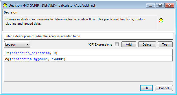

A Decision is a conditional action, the body of which is essentially a function and whose result controls test flow. A Decision can have one of the two outcomes of true or false.
Decision action with true and false results
Any HCL OneTest™ API function can be added as an expression from the Decision editor menu (for example, simple expressions by using XPath value comparison operators, such as equals, less than). Expression arguments can be tags or literals.
  • Chai
  • Legacy functions
Multiple expressions are processed as being joined by a logical AND. To override (that is, join them with a logical OR), enable the OR Expressions option.
Note: The Decision action cannot test whether a tag is populated.
To enter an expression, click Add and type it into the empty input field. To remove an expression, select it and click Delete. To test the expressions, click Test.
Decision action window
You can drag another action onto the branches of a Decision action. For example, to send a message to the console with information about the negative outcome of the Decision function, you can drag a Log action onto the False branch .

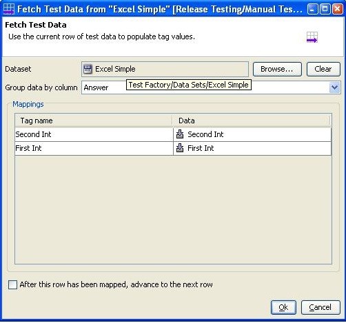

The Fetch Test Data action can be used to map data from a test data source to existing test tags.
Click Browse to locate and select the data source from the project resource dialog. The "Group data by column" list, which is sorted alphabetically, facilitates with working with test data sets containing repeating elements. The column that uniquely defines the rows that belong to the group (usually a parent ID) must be selected.
In the Mappings section, select the data source field to map for each of the wanted tags.
If you run the Fetch Test Data option in multiple iterations, select the After this row has been mapped, advance to the next row option to map the next row of data for each subsequent iteration. If you do not select this option, each iteration reads the same row of data over and over.
Mappings section of Fetch Test Data window
If new columns are added to the test data, the values in the new columns will be used as test data if the following conditions are met:
  • A tag must already exist that exactly matches each new column name
  • The column count property must not be set
  • The Auto map new columns to tags at runtime check box must be selected (the default state) in the data source editor
A message is displayed in the console when the data is added to the test.

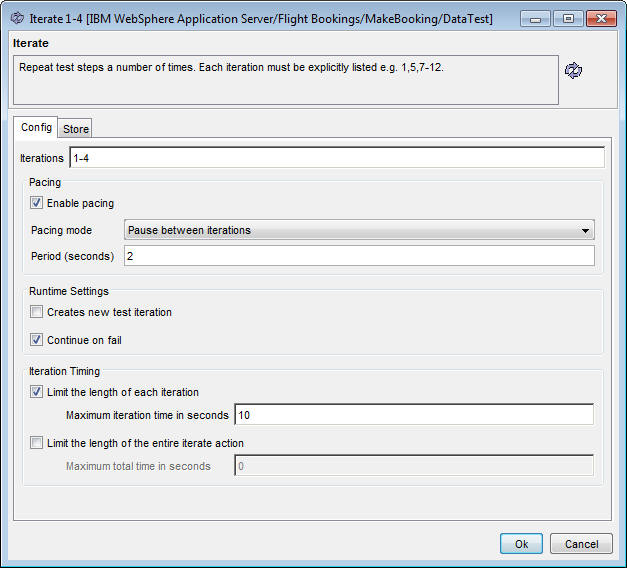

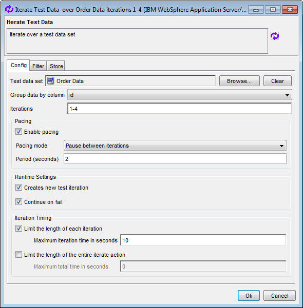

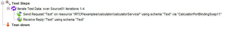

Iterate actions
Use iterate actions to specify repeated test steps or repeated test data.
When you specify test iterations with the Creates new test iteration option selected, the built-in tag TEST/ITERATION/NUMBER is set to 1 and is incremented for each loop inside the iterator. During the test, the Progress column in Test Lab displays the progress as a percentage of the current iteration against the total iterations.
Note: If this option is not used, the entire test runs in a single iteration, and the progress bar moves from 0% to 100% upon completion. If this option is enabled in a test and two iterators are used, the progress bar runs through to 100% in the first iterator, and then again for the second iterator.
You can drag other actions onto any of the iterate actions. For example, you can drag a Send Request and a Receive Reply action onto the Iterate Test Data action. Doing so ensures that you send a request and receive a reply for each line of data in your data source.
The send and receive actions are now under the Iterate Test Data action.

Iterate
Actions within the grouping specified by the Iterate action are run through a specified range of iterations. They can also be run while iterating over a multi-value tag.
The Iterate action
The following options are available for configuring the action:
Table 3. Configuration fields for Iterate action
Option Description
Iterations The numbers of the specific iterations to be run. For example, if you specify "1,3", no results are stored for the second iteration or any iterations from 4 on. You can include tags, as in the following example:
1-%%limit%%
If you specify "9", HCL OneTest™ API does not run nine iterations; only the ninth iteration is run.
You can also specify a multi-value tag to be processed, one value for each iteration. For more information, see Iterate through multi-value tags.
Pacing The following options are available in the Pacing section:
Enable pacing
Select this option to control the frequency of the iterations.
Pacing mode
If pacing is enabled, select one of the following modes:
Minimum iteration time
If an iteration completes in less than the specified number of seconds, pause for the remaining time. For example, if you specify 5 seconds in the Period field and an iteration completes in 3 seconds, a 2 second pause is inserted before the next iteration.
Pause between iterations
In the Period field, specify the number of seconds during which execution should pause between the finish of one iteration and the start of the next. No pause is inserted after the final iteration.
Period (seconds)
If pacing is enabled, enter the value associated with the option in the Pacing mode field.
Runtime settings The following options are available:
If this option is selected, repeated iterations are considered to be real iterations in console output and reports.
Continue on fail
If this option is selected, a failure within the iteration group does not force the entire test to fail. If this option is cleared, an action in the iteration group that fails causes the entire test to fail and any remaining steps to be canceled.
Iteration timing The following time limit options are available:
Limit the length of each iteration
If this option is selected, the active iteration fails if it takes longer than the value of the Maximum iteration time in seconds field. If you selected the Continue on fail option, the next iteration is run; if not, then the entire test fails.
Limit the length of the entire iterate action
If this option is selected, the iterator is canceled if the total time taken by all iterations so far exceeds the value of the Maximum total time in seconds field.

Iterate Test Data
The Iterate Test Data action, similar to the Iterate action, specifies an action or group of actions that can be executed multiple times. The number of iterations, however, is controlled by the number of filter matches found in the selected data set.
Table 4. Configuration fields for Iterate test data action
Option Description
Test data set The data set to search.
Group data by column The (optional) column within the selected data set to use as the basis for repeating elements. When used, all rows within the data set that have the same value in the "grouping" column are grouped and sorted alphabetically as repeating elements.
1-%%limit%%
If you specify an iteration number that is higher than the highest row number in your test data, one of the following results occurs:
  • If you selected the Loop Data option when you defined your test data, then multiple passes are made to satisfy the iteration numbers you specified.
  • If the Loop Data option is cleared, iteration numbers that exceed the number of rows are ignored.
See also Iterate through multi-value tags in this topic.
Enable pacing
Pacing mode
Period (seconds)
Continue on fail
Note: If the tags you populate with this action are later used to populate a message, ensure that any repeating fields in the data set are marked as such in the message. If repeating elements are not marked, errors are generated.
Under the Filter tab, you can specify values to match in columns within the data set. If no filters are specified, everything passes the filter. Text that is entered under the Required Value field is used as an "Equality" match by default. To modify the filter type, click the icon, select the appropriate filter action, and enter the matching criteria as needed.
Only the rows that contain data that matches all filters are used. If the Disable filter when Tag is empty option is selected, the filter is not applied when an empty value ('''' or NULL) is found in the tag.
The Filter page
Note: The number of iterations that are run depends on the following factors:
  • The number of rows that match all filters
  • The iteration numbers specified
Under the Store tab you can map the data in specific columns (within matching rows) to existing tags in the test.
