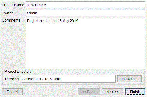

- In the startup window, select Create Project and click OK.
- Enter a name for the project in the Project Name field.
Click Browse and select a location to save the project.
If you do not browse and select a location, the project is saved in the default location, which is your home directory. For example, the default location is C:\Users\USER_ADMIN as shown in the following image.
- Click Finish.

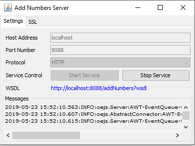

The Add Numbers Server window is displayed.
Click Start Service.
This action starts the Add Numbers web service on the host.
Make a note of the Host Address and Port Number fields. You need them in the next steps.

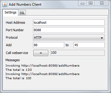

Click the equal sign.
The client application sends an HTTP SOAP request to the server application, which adds the two numbers and returns the result. You can see the result on the Add Numbers Client window. This is a simple, easy-to-understand API to get you started with creating a stub.

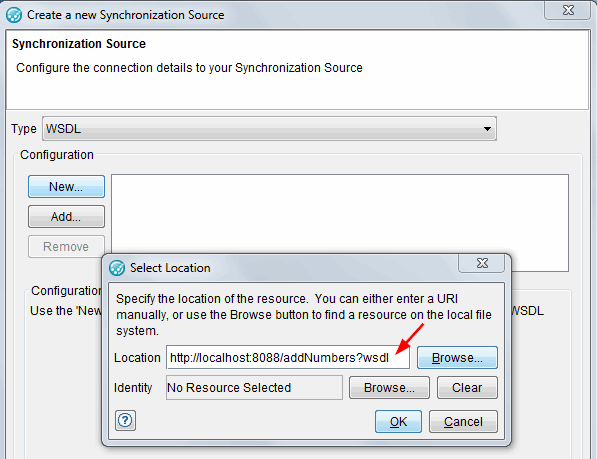

Return to the Add Numbers Server window. Select the WSDL URL displayed in
the WSDL field (
http://localhost:8088/addNumbers?wsdl) and press Ctrl+C to copy it. - Return to the HCL OneTest™ API window. In the toolbar, click Architecture School, and then click Logical View to view the canvas on which you will model the system.
Paste the URL onto the canvas by clicking . Alternatively, in the Synchronization Source window, click
New. In the Select Location dialog box, paste the URL
into the Location field and click OK.
- Click Next.
HCL OneTest™ API creates service components and operations on the canvas to represent the service described in the WSDL file. The options for creating tests and stubs from the service definition are also displayed. You have already used these options to create and run a test in Creating and running a test.

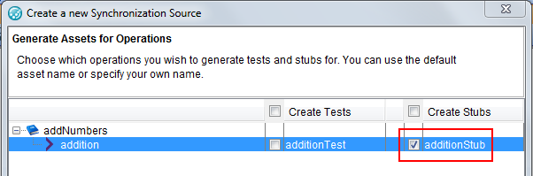

In the Generate Assets for Operations page of the Create a new
Synchronization Source window, select the additionStub check box
in the Create Stubs column.
This action creates a stub for the operation based on the interface defined in the WSDL file.
Click Next.
The Summary page shows the number of items created.
Click Finish.

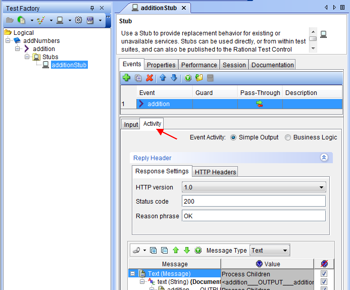

The stub is opened in the Test Factory perspective, which is used for creating and editing tests and stubs.

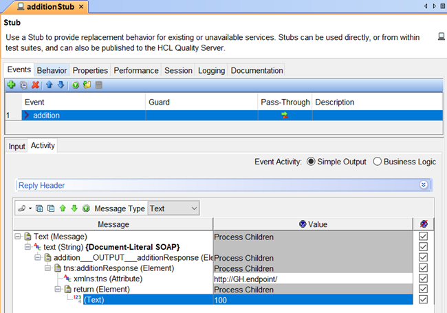

By default, the Events tab in the Stub editor is opened, which shows the events that the stub can handle. In this case, there is only one event for the addition operation. There are two sub-tabs under the Events tab labeled Input and Activity. When an event is selected, the Input tab displays the message that is expected to be received by the stub and that is handled by the selected event.
The stub has the message structure for the SOAP message that the addNumbers addition operation expects as input. In the Activity tab, you can configure the response that is sent or other actions that are taken, when the stub receives a request that matches the data in the Input tab. Both the Activity tab and the Input tab contain the document structure, but no data yet.
On the Activity tab, the last two nodes in the tree called are called return (Element) (an XML element called
return) and (Text) (the text content of that element). -
Adjacent to the (Text) node, double-click the blank cell in the
Value column of the table. Enter the number 100 and press
Enter. This is to check whether it is the stub that is returning the result
in absence of the Add Numbers server.
- Save the stub.

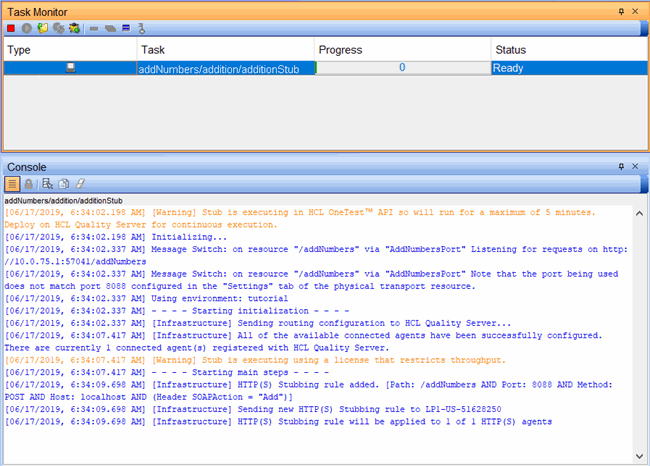

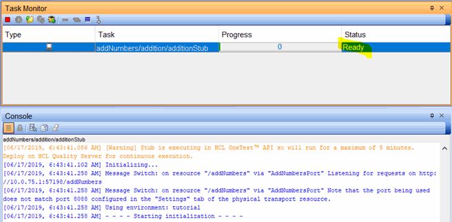

Open the Test Lab view and verify that the stub is still running.
The status of the stub shown in the Task Monitor must read Ready. If it reads Cancelled, run the stub again.
The client returns 100 instead of the correct answer because this is the number that you configured in the stub when you created it in Creating a stub from the WSDL definition of the API.
Instead of calling the Add Numbers server, the request got the response from the stub, which gives you complete control over the responses that the client receives to its requests, for example, while testing error cases.Important: In HCL OneTest™ API, stubs stop running after a specific duration. If the result returned by the Add Numbers client is 133, that is, the actual value returned by the Add Numbers server, return to HCL OneTest™ API and ensure that the stub is still running. For tests that need continuously-running stubs, you must deploy and run them in HCL OneTest™ Virtualization. - Optional:
