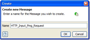

- When prompted, enter a name for the new
message and click OK to proceed.

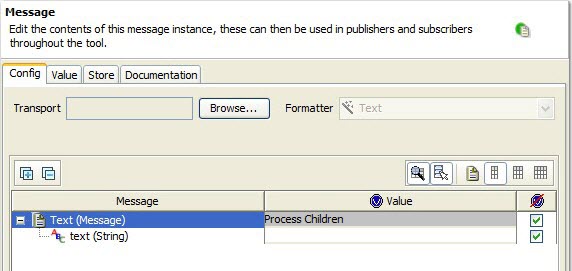

- The message is created and opened for editing
in the work area to the right of the project tree.
- You can now build or modify the message and use it later as a requirement.
