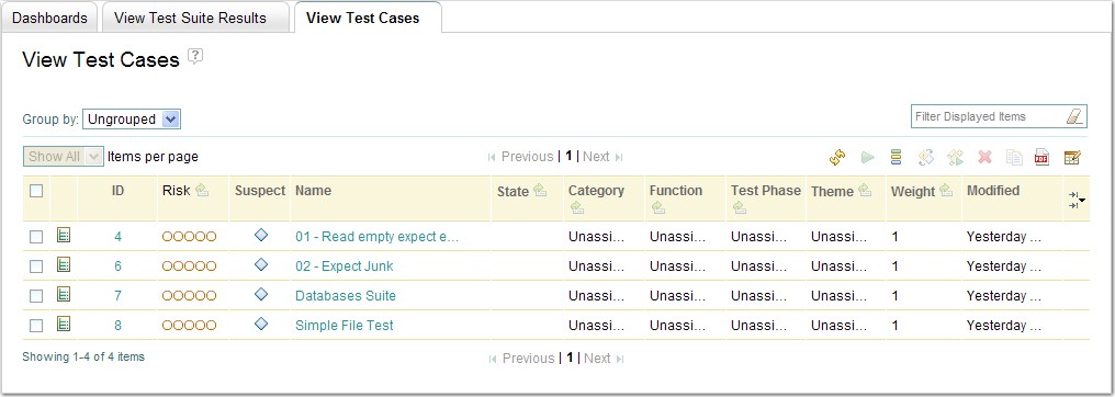

In the Engineering Test
Management console, click Browse Test Cases on the Construction module.
All available Engineering Test Management test cases are displayed, including the cases exported from HCL OneTest™ API.
- Select one of the HCL OneTest™ API test cases by checking the box to the left of its entry in the list.
Click the Run Test Case icon
above the list of test cases.

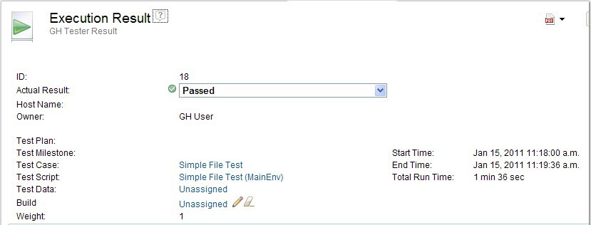

When the execution is finished, the status is displayed in the console, and the Execution completed notification is displayed in the execution tab.
To view the detailed results of the execution, click Show Result.
The results are opened in a new tab in the Engineering Test Management console, showing the detailed execution results (the same as for any Engineering Test Management test case).
In the Result Details section, a link to the HCL OneTest™ API log for the executed resources is available.
Click the log file name to view it.
