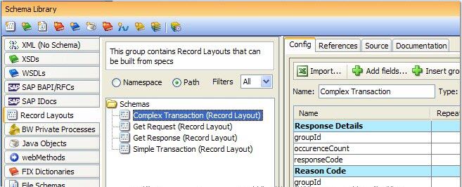

While HCL OneTest™ API built-in support for schema types and message formats is extensive, customers must process and validate messages that use a customized schema or format. For such messages, HCL OneTest™ API provides record layouts, which can be used to define a file schema that is composed of fixed width, custom, or delimited fields. The customized schema can then be applied to a bytes field in a HCL OneTest™ API message.
Record layouts are managed under the Record Layouts tab in the Schema Library.
Existing schemas (record layouts) can be sorted or filtered as usual. The details of any selected schema can be viewed in the Config tab on the right side of the view. The details can be modified, if required.
