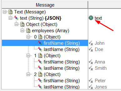

Tag the text (String) node of the incoming message.
Convert it to a JSON object as follows:
var obj = JSON.parse(tags["text"]);Refer to the data values.
- The first person's firstName:
obj.employees[0].firstName - The third person's lastName:
obj.employees[2].lastName - The number of employees:
obj.employees.length
