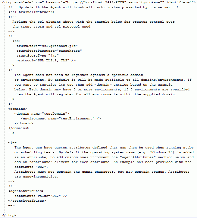

Using a text editor program, open the
Agent.configfile, which is in<Agent installation directory>\config. - Find the server properties at the beginning
of the file:
- Ensure that the
enabledattribute is set totrue. - Set the
base-urlvalue as required.Notes:- The
base-urlvalue must not end with a forward slash (/). - You can specify Internationalized Domain Names (IDN) values as
the host name in the
base-urlvalue. To update the file with the IDN value, you must open the file in "UTF-8" encoding format.
- The
- Set the
security-tokenvalue if you want to use domain-level security for the agent.For more information about security-tokens, see Configuring agents and proxies to use security tokens. - Set the
identifiervalue if you want to specify a name for the agent.The name is displayed on the Infrastructure Dashboard of HCL Quality Server 8.6.0 or later. Assigning a name to an agent makes it easier to identify the agent when two or more agents of the same type are registered with the server.

- If you want to restrict the agent so that
it is available only for specific domains and environments, uncomment
the
<domains>block and enter one or more domains and environments.Notes:- If HCL OneTest™ API Agent was
installed in agent mode, you must restrict the agent so that it is available only for specific
domains and environments. This restriction is because the default
Agent.configfile makes the agent available for running stubs in all domains and environments that are managed by the server. - Each environment
name value must end with a forward slash (
/). Otherwise, the XML is invalid and the agent might not start.
- Save and close the file.
- If the agent was running while the
Agent.configfile was being modified, restart it to enable the changes that you made to take effect.
