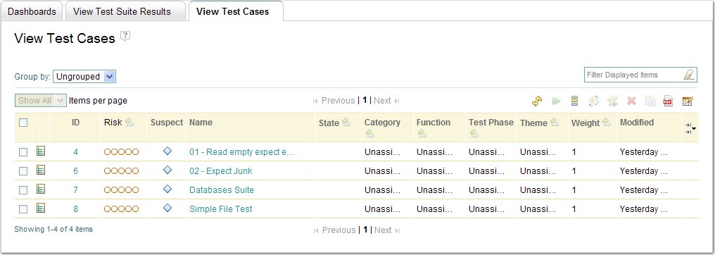

  3. In the Engineering Test Management console, click Browse Test Cases on the Construction module.
    All available Engineering Test Management test cases are displayed, including the cases exported from HCL OneTest™ API.
    View Test Cases list
  4. Select one of the HCL OneTest™ API test cases by checking the box to the left of its entry in the list.

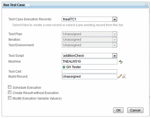

  5. Click the Run Test Case icon above the list of test cases.
    The Run Test Case dialog is displayed.
    Run Test Case
  6. If required, modify the available execution and results options, then click OK to execute the test case.
    Note: The Test Script option can be used to select which test script (that is, which environment) is used when the test case is executed.

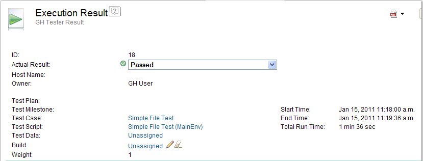

  8. To view the detailed results of the execution, click Show Result.
    The results are opened in a new tab in the Engineering Test Management console, showing the detailed execution results (the same as for any Engineering Test Management test case).
    In the Result Details section, a link to the HCL OneTest™ API log for the executed resources is available.
  9. Click the log file name to view it.
