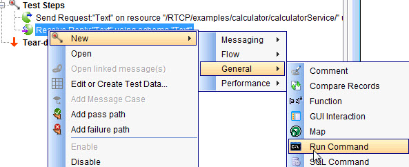

Alternatively, you can add actions from the test editor menu by right-clicking the phase or step after which you want to insert an action. Actions are available by group under the New menu item.

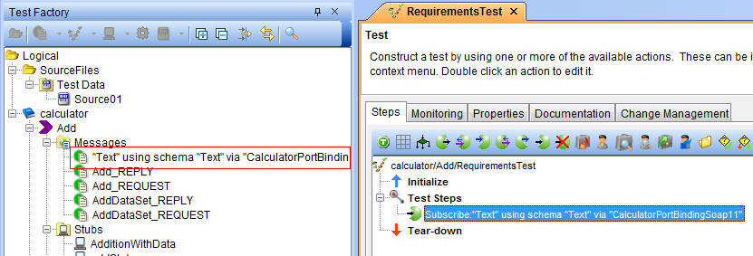

Save messaging test actions (for example, Publish or Subscribe) as requirements by dragging them from an open test and dropping them into a valid branch within the tree in the Test Factory perspective. The contents of the message that contains the selected action (that is, header options, transport, and so on) are reproduced in the new message. The new message is named according to the description of the action that created it.
In the following example, the Subscribe action was dragged to the Messages folder for the Add action. The resulting message was then named for the description of the Subscribe action.
