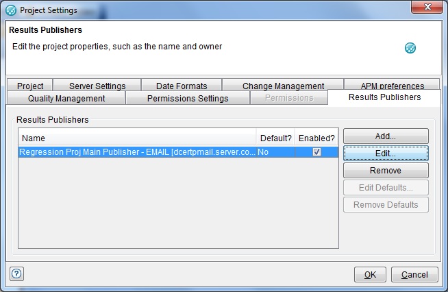

To automatically publish the results of a test suite after it is run, use Results Publishers, which is created under Project Settings. Specify the publishers to use and the details of the results to publish and how to publish them on the Results Publishers tab.
Results Publishers tab in Project Settings window.
Suite execution results are published by all publishers added to the suite if the following two conditions are met:
Publishers are enabled under Project Settings. Results publishing is enabled in the project.
Here is how you specify the publishers:
  • To add a publisher to the suite, click Add.
    To modify an existing publisher, select it and click Edit (see Results publisher settings).
  • To delete the selected publisher from the suite, select it and click Remove.
  • To set a publisher as a default for all test suites (that is, the selected publisher and its settings are applied to all new test suites when they are created), select the wanted publisher and click Edit Defaults. To remove the defaults from the settings, select the publisher and click Remove Defaults.

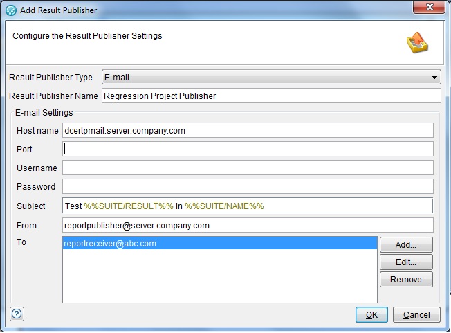

When you add a publisher to a test suite or edit the settings for an existing publisher, the Add/Edit Result Publisher dialog box is displayed.
Add Results Publisher
Select the type of the publisher that you want to create from the Result Publisher Type drop-down list. Depending on the Publisher Type that you choose, the configuration settings change. If you are editing the settings for an existing publisher, the publisher type cannot be changed.

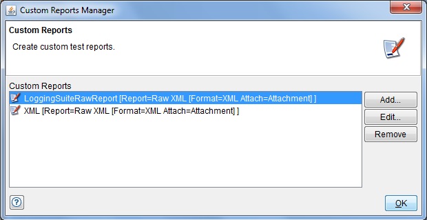

You can manage custom reports in the Custom Reports Manager that is accessible from Tools > Custom Reports.
The Custom Reports window.
A custom report is a report that you define. This report contains one or more of the reports that are available in HCL OneTest™ API Results Gallery (report segment). Each report segment contains a built-in HCL OneTest™ API report and a format and attachment configuration.
To create a custom report, click Add. To modify the settings of a selected custom report, click Edit. To delete a custom report from the list, select it and click Remove.

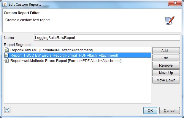

To add or modify a custom report, use the Add/Edit Custom Reports dialog box.
Edit Custom Report
In the Name field, specify a meaningful name or edit the existing name for the report.
Under Report Segments, you can add, edit, remove, and reorder individual report segments that make up the overall report.
  • Click Add to create a report segment.
  • Click Edit to modify a selected report segment.
  • Click Remove to delete a selected report segment.
  • Click Move Up or Move Down (when available) to reorder the selected report segment within the list.
