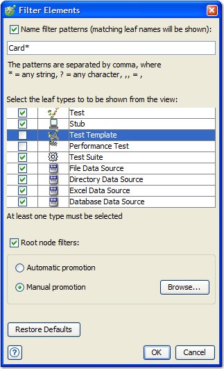

You can filter the contents of the component tree that is displayed in the Test Factory and Test Lab perspectives to show only specific test assets or test asset types. To configure the view filters, click the Configure Filters icon in the toolbar.
You can enter a name filter to hide all test assets that do not match the specified pattern (for example, Card* hides all assets whose name does not begin with "Card"). Name filter patterns are case-sensitive.
Additionally, you can select specific test asset types to hide from the view by clearing the check box next to their type.
Finally, you can set manual root node filters by enabling the Root node filters option. Select the Manual promotion entry and click Browse to locate the node that you want to promote. The selected node appears as the root of the project in the component view.
To remove any filters and restore the default view, click Restore Defaults.

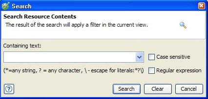

You can search for test resources within the Test Factory and Test Lab perspectives by clicking the Search Resource Contents icon. The search examines the contents of every file within the project (for example, fields within messages of a test, the contents of a function within a test), and applies a filter to the current tree view that displays only items whose contents match the search terms.
Search resource contents
In the Search Resource Contents dialog, enter the search string and select or clear the Case sensitive check box. To select from previously used search strings, click the arrow on the search field box and select the required string. To use a regular expression for your search, select the Regular expression check box.
Note: To filter on multiple strings you can use the pipe symbol (|) as an OR operator (for example, "getData|sendData" displays both strings in the filtered view).
When finished, click Search to filter the component tree according to the selected search term.
To restore the tree to its unfiltered view, click the highlighted icon and click Clear in the Search dialog.

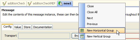

When multiple requirements or test assets are opened for editing (see Test Factory), the opened items can be organized into groups by dragging their named tabs into an existing editing panel.
To create a new group, drag an open item into its own editor. When you drop the tab, you can create a new horizontal or vertical group from the pop-up menu that appears.
Note: You cannot use vertical and horizontal groups at the same time.

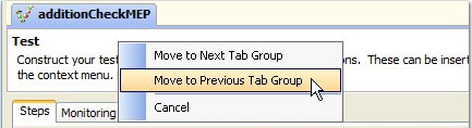

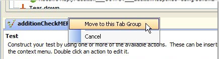

To move an open item to an existing group, drag it on the required group and select Move to this Tab Group from the pop-up menu.
To move an open item to the next or previous group (when at least two groups exist), drag it into its own editor and select the required option from the pop-up menu.
