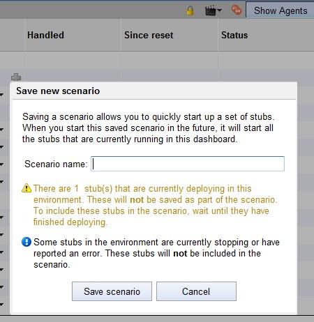

Before running tests, you might require several stubs to start in your environment. Selecting individual stubs to start each time takes time and might also mean that you start the incorrect ones or that you forget to start some.
By saving a scenario, you can quickly start a set of stubs. When
you start a scenario, it will start all the stubs that are currently
running in the dashboard.
