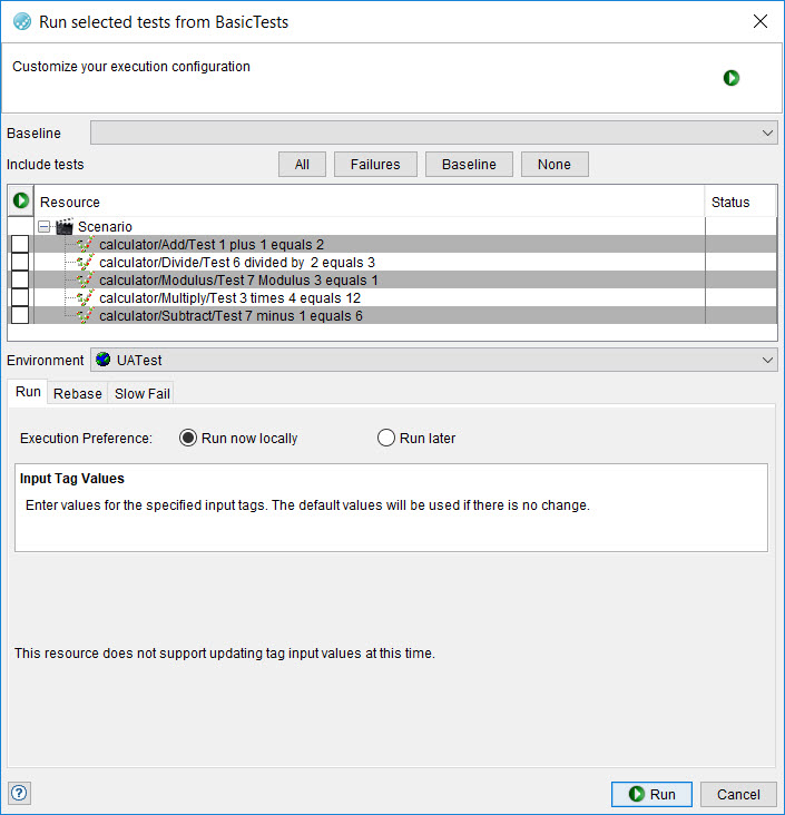

  1. Open the custom execution dialog box in one of the following ways:
    • Select a test suite and press Shift + F5.
    • Right-click a test suite, and then select Run from the menu.
    • Select a test suite, expand the Run icon in the main HCL OneTest™ API toolbar, and then select the Run option.
      The Run selected tests from <test_suite> window is displayed.
      Image of the run test suite dialog box.
      Note: If you ran the test suite previously, all the previously run instances are displayed in a list in the Baseline field.
  2. Perform the following actions if you want to run tests from previous instances of runs:
    1. Select the instance that you want to rerun from the list in the Baseline field.
      The contents of the selected instance and individual test results are displayed. All the tests that were previously run are displayed as selected for the current run.

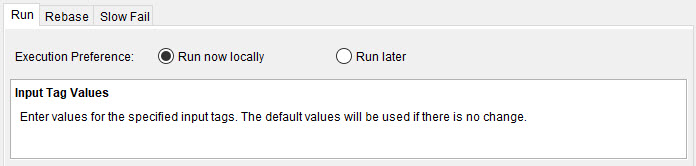

    • Run now locally
      No further options are required. The test suite starts to run immediately after you click Run.
      Image of the Run tab

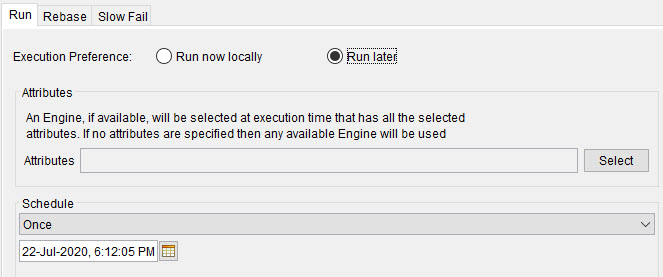

    • Run later
      Image of the run later option in the run tab.
      Perform the following steps:
      1. Click Select and then select the attributes of the engine on which the test suite is to be run.
        These attributes are used to determine the engine to run the selected tests at the scheduled time.
        Note: The attributes that are added for a scheduled test are displayed in the Details panel for a running agent in the Infrastructure Dashboard on HCL Quality Server and are removed from the display when the agent is deleted from HCL Quality Server. You can use the attribute in filters as the attribute is available in the computer on which the HCL Quality Server is installed. The attribute is not removed after you delete it until you restart the computer.
      2. Select the frequency of running the test suite.
        For example, you can run the test suite once, daily, or repeatedly.
        Specify the options for the frequency that you select.
        The test suite is scheduled to run at the specified time on the day selected.

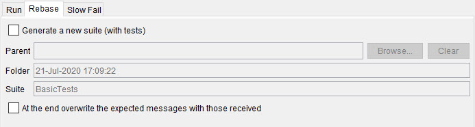

  6. Click the Rebase tab, and then perform the action as described in the following table:
    image of the rebase tab.
    Option
    Action…
    Results in…
    Generate a new suite (with tests)
    Select this option only if you want to create a test suite from the tests that you select for the current run.
    The tests that you select for the current run are added to a test suite that is created.
    The following fields are enabled when you select the Generate a new suite (with tests) option:
    Option
    Action…
    Results in…
    Parent
    Click Browse, and then select the required component, folder, or operation where the test suite is to be created.
    The test suite is created in the location that is selected.
    Folder
    Enter or modify the name of the folder in which the test suite is to be created in the Folder field.
    The test suite is created in the folder that you specified.
    Suite
    Enter or modify the name of the test suite in the Suite field.
    The test suite is created with the name that you specified.
    Option
    Action…
    Results in…
    At the end overwrite the expected messages with those received
    Perform any of the following actions:
    • Select this option to overwrite expected messages in the tests that run with the messages that are received.
    • Clear this option if selected, to retain the messages in the tests.
    Depending on your selection, the results can be as follows:
    • Messages in the tests are overwritten with the messages that are received.
    • Messages in the tests are retained and not overwritten.

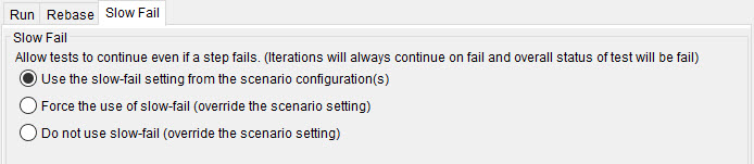

  7. Select any of the following options on the Slow Fail tab as described in the following table:
    image of the slow fail tab
    Option
    Description
    Use the slow-fail setting from the scenario configuration(s)
    Selecting this option does not override the Allow tests to continue even if a step fails setting from the configuration in the scenario.
    This is the default option and the test fails when any step in the test fails.
    Force the use of slow-fail
    Selecting this option has the same effect as selecting the Allow tests to continue even if a step fails option from the test configuration.
    Do not use slow-fail
    Selecting this option has the same effect as clearing the Allow tests to continue even if a step fails option from the test configuration.
